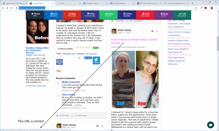

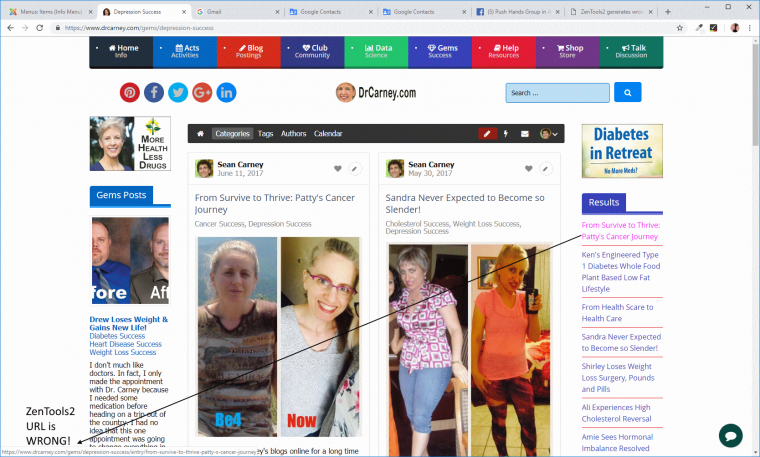

Basically all of the Titles within the Menu and submenu pages which are creating correct urls based on the primary category.
The links in the ZenTools2 module are building wrong urls.
I hope it won't take a month to get somebody to help with this.
Here are two pictures which I hope will be worth a thousand words:

    Actually, it still redirects to the correct page of that EasyBlog post but you're right, there is something wrong with the generated URL. Let me check with our developer and will get back to you.
