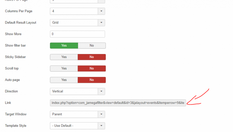

    But if Mijosef also lets you rewrite URLs, use the non-sef URL you can find in the Megafilter menu item, and create a new SEF URL for it.
    dpitfield No, you need to get the NON-SEF url from the Menu Item. When you access the Menu Item editing in the backend, for each Menu item you will see a field that says "Link".
    This is the URL you need to rewrite:
