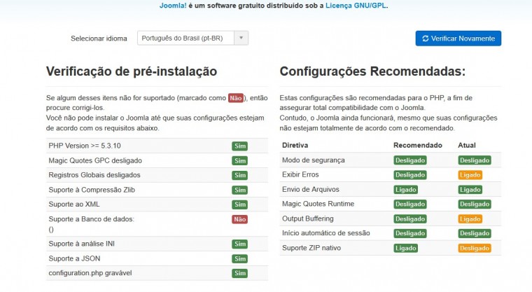

I'm having problems with the installation of the quickstart. It does not end the installation. Could you help me?

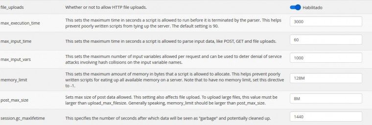

If the installation has been started and it stuck in progress, this can be issue due to lower PHP values on your server.
Kindly increase the max execution time to 300 and memory limits to 512M
Re install the package and it will be installed.
If still there is any issue, kindly let me know on which steps installation stuck.
Hi Pankaj,
The suggested changes have been made but continue to give error. What can I do now?

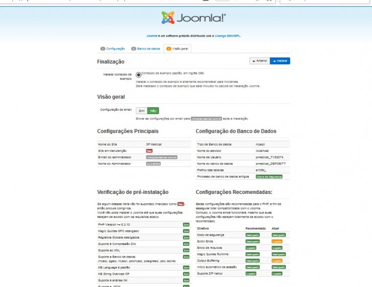

    i am not able to understand the language in screenshot.
    Kindly edit fields in first post and submit the Cpanel login and DB username,host, DB password and folder to install it.
    I will check it on your server.
    Hi Pankaj,
    Very kind of you. I already edited the informations you need.
    Thank you so much.

      Hi edna-bonfim
      There is a problem with your database as you can see here
      This has nothing to do with template , it is a host server configuration missing , you should ask your hosting provider to fix it -
