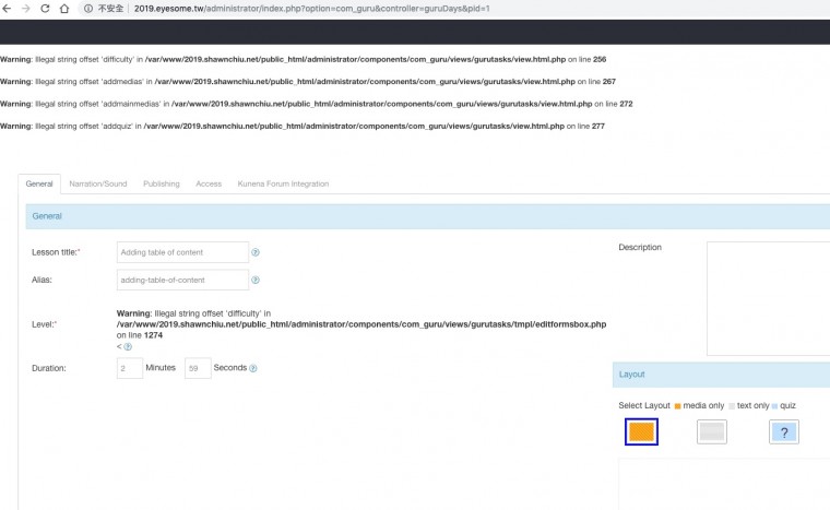

Hi, I recently asked a question about guru light error. Now I figure out that it is because I was using php 7.2 env.
The Warning: Illegal string offset....is resolved with php 5.6.
Unfortunately, I am asked to have at least php 7.1 on product machine. Will you improve your code on the next Guru light version? What is the requirements of running Guru light and Guru pro?

    Kindly provide the screenshot of error and page URL on which you have this problem.
    So we can check it to see the problem.

        Hidding the error report doesn't help. I CANNOT assign difficulty (the dropdown list is gone).
          shawnhy
          I did not said to hide, Set it to default. that is recommended to set the error report except you are doing testing in development. The errors are PHP warnings you have to set the report to default.

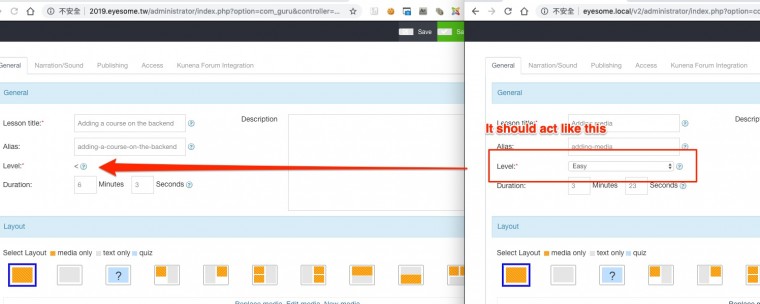

            I see you've changed the system conf. Please check the attached image. There is a dropdown list when I run site on php5.6
              shawnhy
              I shared the details with development team on this, we will give you an update very soon with fix.
              Please log via FTP and replace this file:
              "administrator\components\com_guru\views\gurutasks\view.html.php" with the attached one (unzip first the attached file).
              This change will be added in the next Guru Light version.
