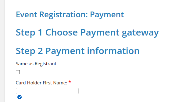

There are no payment selections on the check-out screen, just a blank line for one before the payment information area. We’re using PayPal and this is set in both JA Payment and the dt gateway pay options. The dummy test gateway worked fine, but the live gateway - not so much. Always getting a ‘Payment gateway not selected’ error.

But several problems still remain. On registration checkout after the confirmation screen and when on the payment selection screen, it immediately forwards to the payment processor. It does not allow the user to make a payment selection or correct any of the billing information.

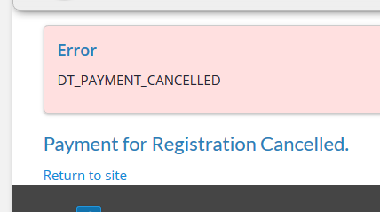

This is the error after payment cancellation. The cancellations complete as they should, but an error is still displayed.

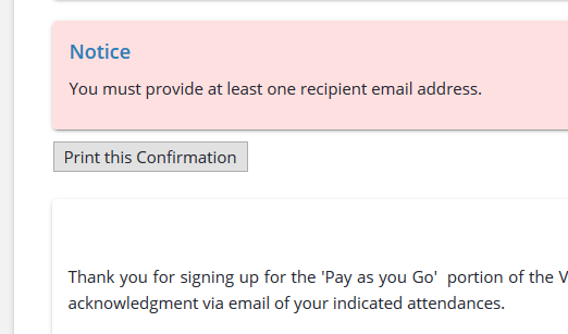

This is the error displayed after registration. Email addresses are required on the registration forms, but this messages indicates that none exist.

      I just tested the checkout function and the confirmation screen holds for a few seconds now, but it still forwards to PayPal before any selections have been made.
      Also, on payment cancellation, the error 'Error DT_PAYMENT_CANCELLED' displays.

          For the Paypal payment method, if you use Paypal only, it should be redirected to Paypal automatically, no need the card info (fields underneath payment gateway option).
          With the message: DT_PAYMENT_CANCELLED , it looks like your site missed the translation for this error message, you can open the language file: /language/en-GB/en-GB.com_dtregister.ini (in case, you use English)
          Find this language string: DT_PAYMENT_CANCELLED
            This is a screenshot of the paypal payment verification screen that it is blasting through. As you can see, registrants do not have a chance to complete the form before the program forwards to PayPal. This will cause enormous confusion with those trying to register.
            I am very familiar with the language files and this is the first thing I checked and it is correct. However, as you can see from the screenshot below, the correct translation is being displayed on the screen along with the error message. If the error message were picking up the translation, it would state:
            Error - Payment for Registration Cancelled.
            What sense would that make? So, why the error message in the first place?

              As I mentioned above, with Paypal, no need for that info and the team is working onepage checkout for DT Register, it will remove the fields as you can see now. it's undergoing testing and will be release soon.
              For the notice message: "You must provide at least one recipient email address." It took time to check the code but the problem comes from the wrong syntax you add in the option: Send New Registration Notification Emails To : https://prnt.sc/n77v75
              There should not be ";" semi colon after the email address. We updated for you, kindly check.
                saguaros
                I've removed the trailing ';'. This was probably left over after removing a third email. Thank you for discovering that.
                The large group of membership in this club are in their seventies and over and it doesn't take much to confuse and upset them. The blank payment fields and then the screen forwarding to PayPal immediately will cause angst for many. Believe me, I've had to field these types of issues in the past and "it ain't fun".
                I have also tested with a 'Pay Later' selection and it does stop the transfer and allows the form to be completed, but the client does not accept later payments. If there were a way to 'display:none' for the Pay Later selection only, that would hide it from the grouches. But all payment types are class='payment-label' and this will hide the PayPal selection as well, but a selection still must be made.
