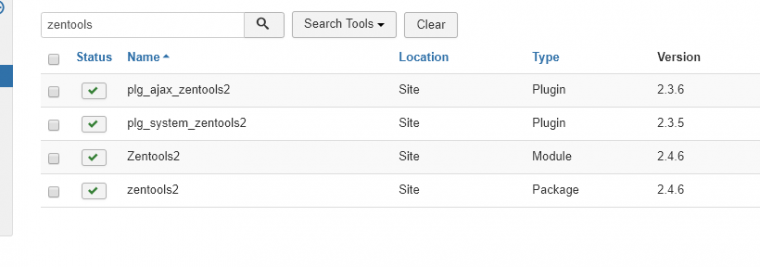

    nyafleron Hi. Do You have any zentools module used on site? Maybe You should uninstall them alltogeteher.
    Of course only if this will affect Your site. And of course please make a backup before that.
    I did uninstall the old version of zentools, but it didn't fix the issue. Should I remove the zentools files manually? Right now, I am only using the zentools 2 module, and I have spent a lot of time setting up all the different galleries, which the site is primarily run by, so I don't want to uninstall zentools 2 now. I need that module. Is there anything else I can do? Thanks teitbite

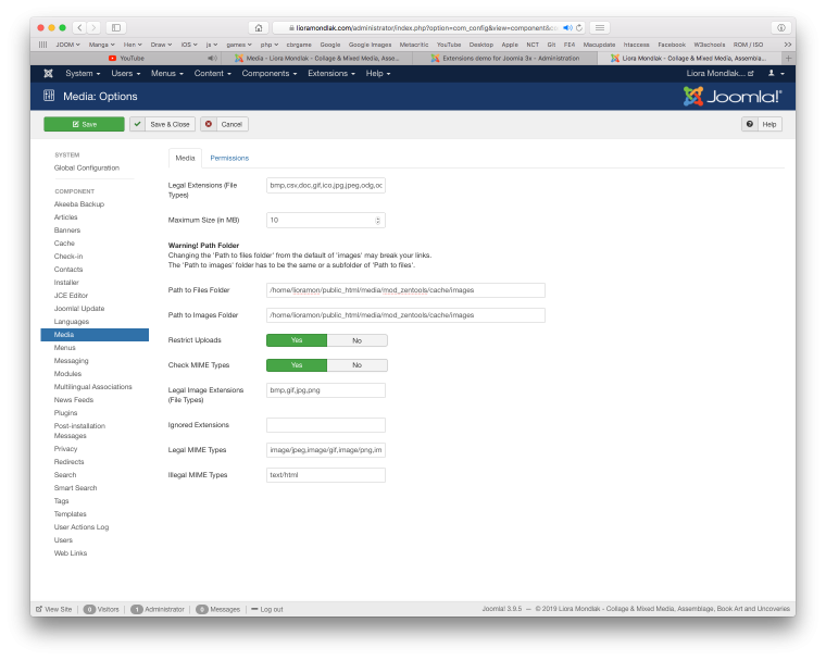

          The problem comes from the Path of media (images/files) in media options you set in backend
          Try to use default 'images' path and see how it goes.
