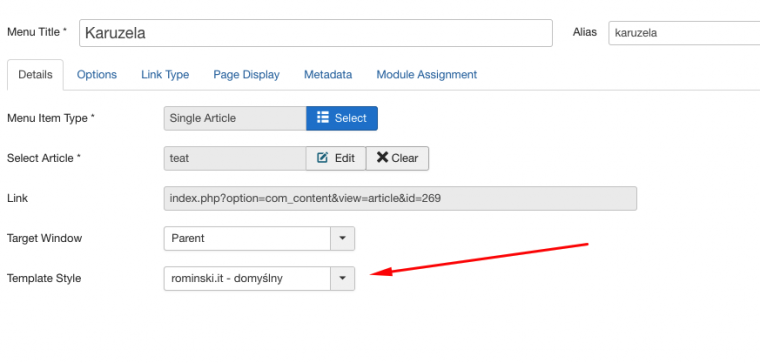

        You should assign a template which has content block inside it , i changed template assigned to menu item
        I understand the problem is still showing other page elements, e.g. the blue bar at the top.
        In another template style, it has a different position. I copied the module and matched the current position - the problem is with the appearance of the bar - a completely different look.

              You should edit module and choose at each menu item assign it
              I think it is already ok
