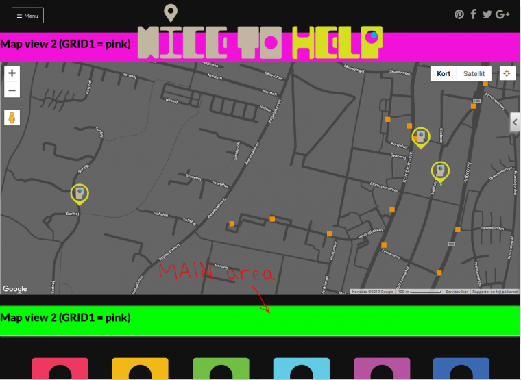

    I just create a Custom HTML module to show an article or "Hotspot Pro" component. Then I assign that to the Menu Item to appear in position GRID1. For unknown reasons its shown twice, as the MAIN area emerges below GRID1 area.
    The areas has been colored to be identified:
    GRID1 = pink
    MAIN = green

      Please try one of the Menu Items and you'll see what I mean:
