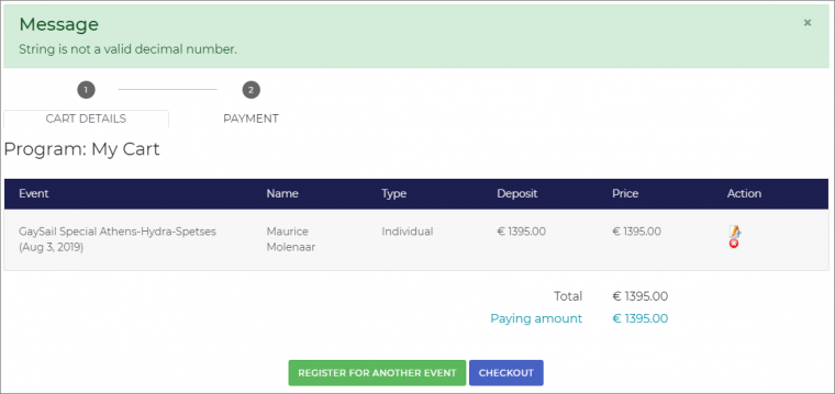

                saguaros I have just checked. The paying amount in the cart now shows the correct price (instead of €1). But when I click [Checkout] and try one of the payment options (through Mollie) I go back to the cart and get this message:
                Message
                String is not a valid decimal number.
                This did not occur before.
                  webcasebv
                  Our dev updated this file on your site:
                  /plugins/system/ja_payment/lib/helper.php
                  Kindly check.
