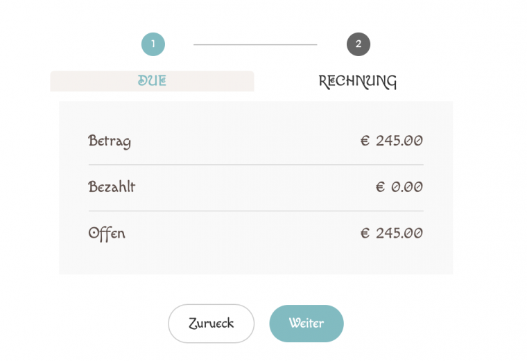

      next issue: when i create a booking and like to pay it later. and then change the due value in admin backend... it is not represented in pay now option.
      For example booking: IDM-19-T0-SC-D-5726383 should now cost only 1 euro because of admin change.... this is also shown in frontend under my bookings ...?controller=user&task=index so here it is correct.
      When I click now to "pay now" i get shown a wrong due (245€)
      This wrong value is also send to payment gateway.

          So Record: IDM-19-T0-SC-D-2149857 costs original 45 € i modified it in backend so that it costs only 1 € than I used the Pay Now option from frontend like discribed above. Now your fix show me 1 € and this is also given to Paypal... (thats the working halve) when it comes back from paypal as payed ... it seams that he recalculate the price of the record and throw away what ever I modified in backend. So now the record costs again 45 € but 1 € is already paid. Emails are generated also like this with 44 € are open. so consitent wrong 😉 Also the paypal transaction number is not stored back to the record... and as there is something still open the record is not marked as paid.
            Bobblue . "Item Price" can't be changed as it is related to event basic price . When ever someone pays . All fee items calculated base on that basic price . "Amount Paid" can be changed .
