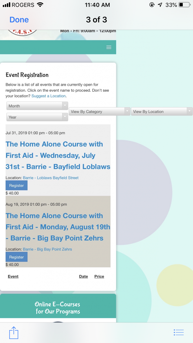

On this page, the filter fields at the top are "falling off" the page on mobile. See attached screen shot.
I've tried installing different themes and it did not fix the issue.

It due to your override in Joomla template on your site: /templates/pb_seconds2/html/com_dtregister/
As I can see it's using table markup for event list in DT Register which is totally different from the default markup of DT Register as you can see here: https://joomlaeventregistration.com/demo/index.php/themes/grid-2-theme
Kindly check your override again.
Perfect! Thanks. We originally set this up some years ago and I totally forgot about the overrides. Thanks again for the assist on this.
You're welcome, Scott!
