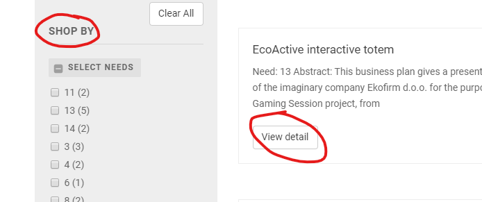

How can i change the word "shop by" or "view detail"?
See also attachment.

1- 'Shop By'
You go to Backend > Extensions > Language(s) > Overrides and add translation text for this language constant: COM_JAMEGAFILTER_SHOP_BY
Like this: http://prntscr.com/omueae
2- View detail
Do the same with this language constant: COM_JAMEGAFILTER_VIEW_DETAIL

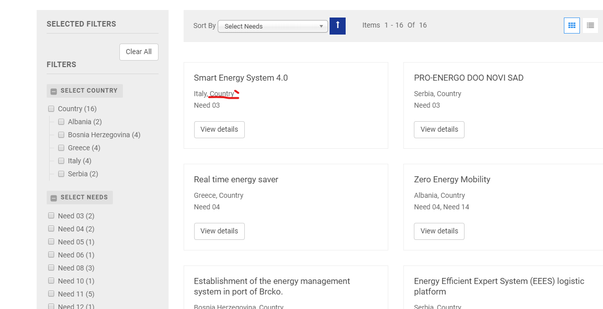

My site is http://powerports.eu/call-for-solutions/solutions-database#sort=attr.ct1.frontend_value&sortdir=asc
I have attached a file to see what i want. Can somehow to remove the Country word? and only to appear the name of the country?

The filter was made from K2 component. I dont know why appears there.

I check that page and see that 'Country' text is parent category of countries list: Italy, Greek, etc... when you select to show the category name, it will show all categories's names there
Can i disable it somehow to dont appear? with code perhaps? is it possible?
Thank you
konstantinos999
I tried but with the current code structure, it will load & show all parent categories there. Could you try to restructure the category list?
