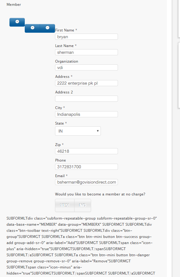

I upgraded the site because the client was having trouble getting Simple Group Registration to display correctly. I'm not sure of the chain of events, but it was originally set up as Detailed Group Registration, but was showing this:
It seems that upgrading to DT Register 4.2.4 fixed that error, but now I'm getting the subject error when registering for an event without being logged in:
