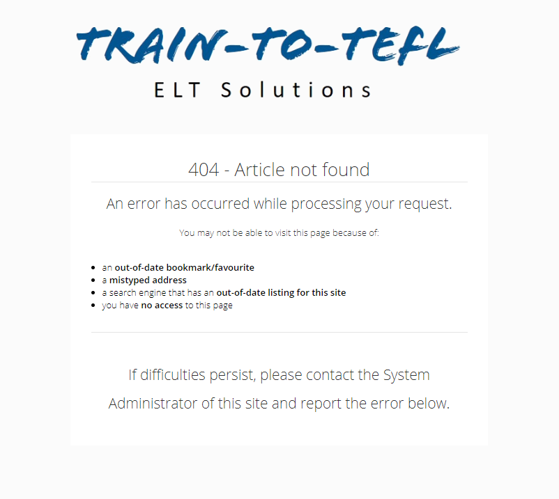

Can you advise me how I include the logo image on the error page on the medica template?

paulus1031 Can you advise me how I include the logo image on the error page on the medica template?
Logo image in 404 page is already included in quickstart template, it is using error.php page code to publish in position logo a custom module named logo

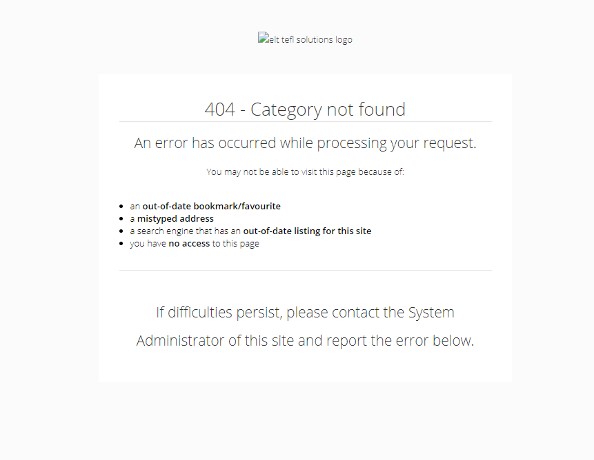

Ok it seems that the wrapping in a tag of the logo breaks it
Using the joomla menu system means the link does not quite work correctly

I get this when trying a link in a drop down
Top level link it works
In the console window the path to the logo image is wrong hence the 404

Yes it is the same as the quickstart , as i showed it works fine on my local , pure quickstart nothing else

added <base href="<?php echo $this->baseurl; ?>/" /> at the suggestion of a former JB developer and this has done the trick
