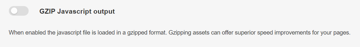

This can happen due to a problem with the template files being compressed or zipped
Check see if disabling javascript compression if enabled works
This is found in the settings tab of the template settings page
