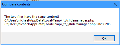

      saguaros No change, file in module folder and file in zip are identical. Still loads Joomla K2 item browser in pop-up and when you click an item it will open the editor.
      The .20200205 file is the original, the .php is the file from the zip you attached.
