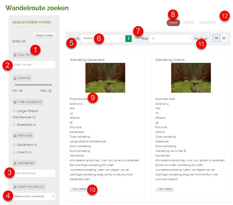

I installed JA megafilter, see: http://www.wandelroutes.online/index.php/wandelroute-zoeken#sort=position&sortdir=desc

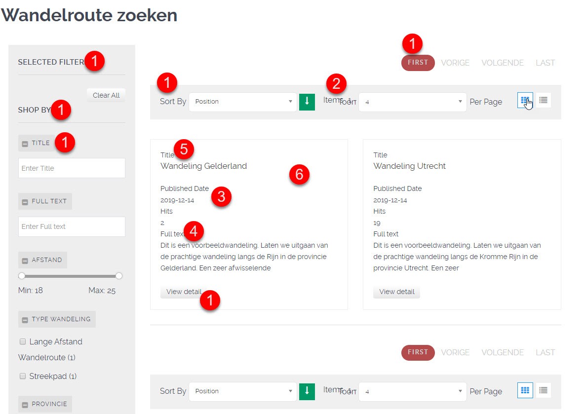

See also the printscreen with the numbers. Number correspond with my questions.
1. Some text is in English. How/where can I translate that in Dutch or use a completely new/other text?
2. Layout is messed up there, unreadable. How/where can I fix that?
3. Published date and the date itself are on 2 lines instead of 1. How/where can I fix that? Same problem other fields.
4. I do not want to show the word "Full text". How/where can I fix that?
5. I do not want to show the word "Title". How/where can I fix that?
6. How can I show a photo here? Or thumbnail?
7. In general: what would be the best option to do my css changes? In the custom css file of the template?
8. I read https://www.joomlart.com/documentation/joomla-component/ja-megafilter . Is there more documentation?
Thanx!
    Hi mlehr
    1 - Perhaps this topic can help: https://www.joomlart.com/forums/d/24108-about-changing-filter-words
    2 - 3 - It may due to the template you're using, kindly share the admin + FTP account of your site, I will check for you.
    4 + 5 - These are titles of fields, you can turn off it via filter settings in Backend > Component > JA Megafilter > edit filter > Page Options: https://prnt.sc/qbbsd7
    6 - In the same filter settings > Page Options > make sure that you drap & drop the thumbnail to the right column to show on frontend: https://prnt.sc/qbbt17
    7 - Yes, it's best if you put your custom css into the override of template, normally a Joomla template offers a place to put custom css.
    8 - It's documentation page of JA Megafilter only, if you're not clear in anything, pls let us know.
      Thanx saguaros
      1. I tried language overrides. My language is Nederlands (Dutch). When I search for constantes COMJAM... nothing is found. When I set the language to English I do find the constates. How/where can I fix this?
        I found the answer my self, so you don't have to answer this question. :-)
      2. I tried several templates, but all show the same problem. Dit you receive my Joomla login?
      3. -
      4. Oké.
      5. Oké.
      6. I did. I only see the thumnail in the sidebar filter, but not in the search results. In the backend it says: GD2 library must be installed. Is that the problem? How can I do that?
      7. I did and overrides work fine for Joomla content, but not for the Megafilter. E.g. I changed this background color: .ja-filter-wrapper .filter-content .filter-options-title span {
        background-color: #da3231;
        I put in the custom.sccs. But the new color is not loaded, so nothing happens. Please advice.
      Hope you can help!
        mlehr
        2 - 3 - It due to the style of template you're using which override the Bootstrap style and cause the issue.
        6 - I check articles on your site but you did not add any image for article: https://prnt.sc/qceoba
        7 - I don't see that file on your site now, try with this custom css:
            background-color: #da3231 !important;
          saguaros

              See printscreen. Where a number is, I cannot translate.

                        Still remains the styling issue that you see on the print screen at the red arrow. Can you give me the css code to resolve this? Then I will put it myself in the right file.
                        And do you also let me know about the translations? See my previous posts about this and the large print screen with all items that are not translated.
                          mlehr
                          It due to the space which is not enough to show all per row like that.
                          You can use this custom css:
                          .products-toolbar #limiter_chzn {
                            width: 100px !important;
                          For the translation, you can find the language constants here: /language/en-GB/en-GB.com_jamegafilter.ini
                          For example:
                          COM_JAMEGAFILTER_SORT_BY="Sort By"
                          You open the associated language file on your site: /language/xx-XX/xx-XX.com_jamegafilter.ini (xx is your language code)
                          COM_JAMEGAFILTER_SORT_BY="your desired text here"
