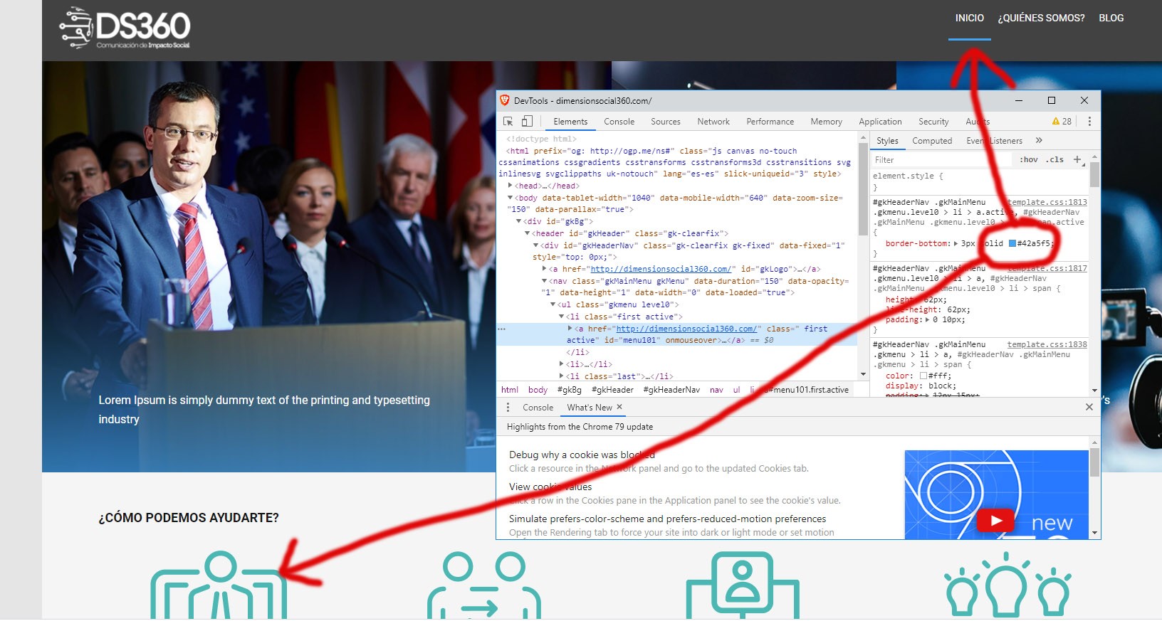

      About the color kindly give me screenshot as template does not has any settings for this.
      I need to change all hexadecimal values from the blue of the template to the green of the elements below. In "template.css" comes 38 times that value, which I must replace with # 22d3c5

        About the top color use this code in the override.css file
        #gkHeaderNav .gkMainMenu .gkmenu.level0 > li > a.active, #gkHeaderNav .gkMainMenu .gkmenu.level0 > li > span.active {
            border-bottom: 3px solid #42a5f5;
        change color code as per needs.
