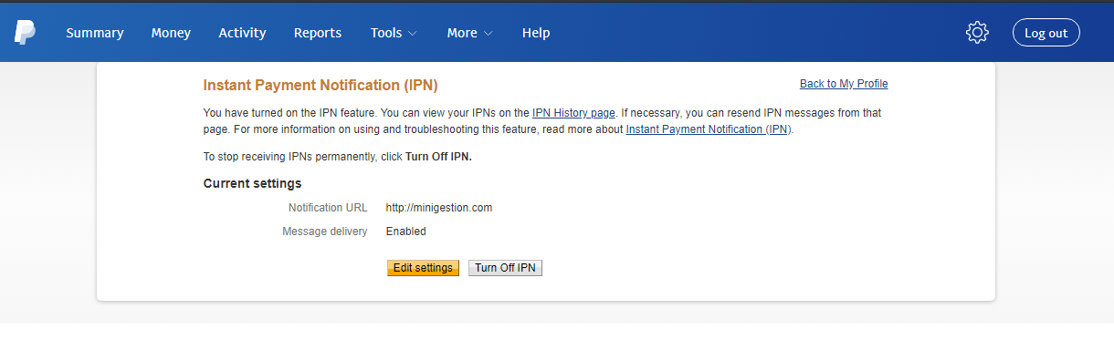

    In your paypal account, did you try to enable IPN?
    It will help on this case when registrant doesn't click Return to Merchant button after checkout.
    Yes, IPN was on and even if they don't press "Return to merchant" I receive an IPN that is the only feedback I get for the transaction.
