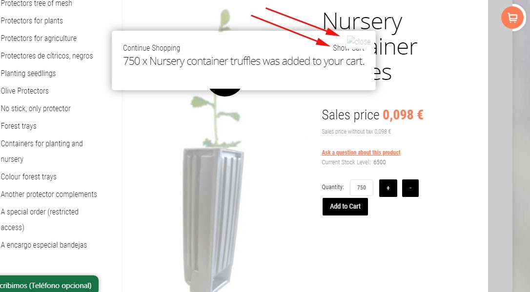

We have a problem with the Pop Up Continue Shopping/Show cart.
The image fancy_close.png not appears.
Failed to load resource the image fancy_close.png: the server responded with a status of 404

    Hello. No. I only modified the position of the "nul image" "close" and now appears on bellow because as you can see in our screen shot, it was above the text "show cart" and was not possible to read it ok. But I not modifie that if it can appears like your demo. I remmember we had the same problem before. After update Joomla and Virtuemart it appears again. Thanks!

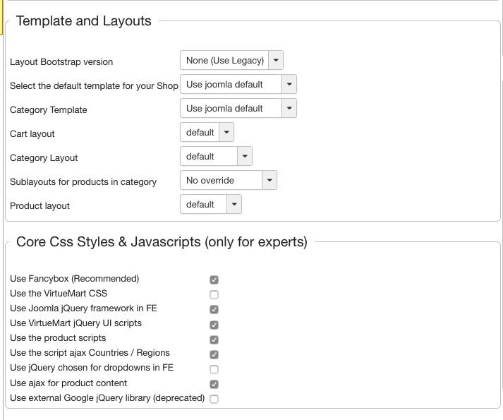

                It's quite hard to check without seeing that closely. As I mentioned above, the markup seems a bit different with our demo site, here is screenshot of settings of our demo site in VM configuration:
                You can compare with your site.

                  Hello, sorry for the delay to answer. When I check Fancy Box it appears ok, thanks. I was forget to select it. Now it's solved!
