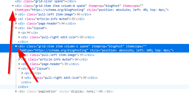

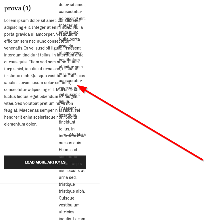

as attached images, I have a column alignment problem for the Decor template, in practice when I activate the blog page the display in columns is not correct, a sort of "sub-column" is created as the attached image, I hope I was clear, sorry for my English.
regards.

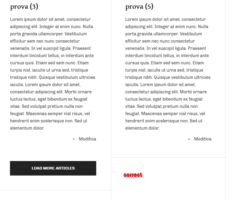

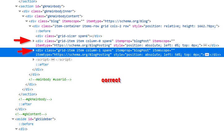

P.S.
I have inserted the last two images as it should be correct

    I guess there is wrong HTML markup in one of these items on this page and it breaks the layout.
    You can try to temporarily disable one by one item on this page to find out which one causes the issue and check the content of that item in backend again to see what's wrong.
