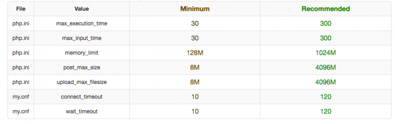

    The issue on your site is the Memory limits value is -1
    Kindly set the PHP value as recommended here :
      Ninja

        These setting are not on the Joomla its on your server php.ini
        You can raise a support request to hosting provider and ask them to increase these values as recommended in the screenshot, they will do it for you.

            This is not something issue from Jomsocial you can see it in your Joomla panel the system information tab, the requirements doesn't match even with minimum requirements that needs to upload files.

                In Joomla system information it will be changed if the server memory limits are changed.
                you can see here : http://prntscr.com/sfpnla its -1 kindly ask hosting provider to make it as recommended value. its normal system requirements. This is something must be updated on the server as you can see the details are not valid.
