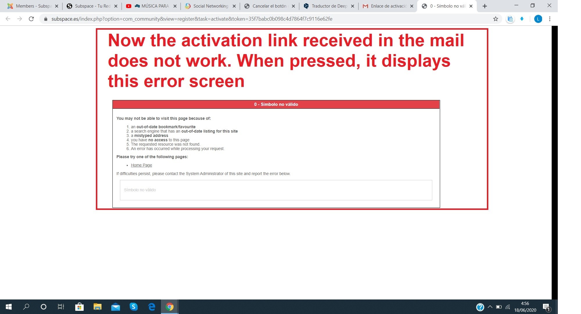

May i know the error as this is skip button if user not want to upload the avatar.
process is same

There is redirection error, it can be due to wrong configuration in redirection plugin or you have force upload avatar plugin. please edit fields in first post and submit site super user login. I will check it.
    Hey Pankaj, I'm fixing the redirecting error. It's a topic related to friendly Urls and rewriting. It is a task that I must do with patience, if I activate the option of rewriting the pages or sections of my site show me the error 404. To correct that error I must follow a tutorial and create the 301 redirect to those pages.
    As a solution to the issue of mandatory avatar upload, and not allowing a user to register with JomSocial's default avatar, can I disable the Skip button action?
    I don't think it's right for a user to sign up with the default avatar and once they log in to my site force them to change their avatar. Can you tell me if there is an option to override the Skip button and not have it perform their task and how to do it?

      The option is in the core and would not be skipped, there is skip button on your site that is working.
      About the error i need site site login to check, once i have login after that i can give you exact cause of this error.
      As Jomsocial does not offer such error even if user not upload the avatar.

        Please check it now.
        I disabled the System - JS Force Avatar plugin since you have Joomla consent plugin enabled too.
        Now user have to consent Joomla condition first as this plugin enabled and he will not be force to upload avatar.

          Ninja Hello pankj I checked it and this is what happens, it gives error, you can see it in the attached screenshot. What I need is to make the user when registering upload an avatar photo. I do not want you to access with the default photo of JomSocial and if you access the site you are required to change your photo for a personal one.
          It's like letting a barefoot man into my house and then forcing him to put his shoes on. Do you understand me now or is it a language problem?

              when When i tested the fields plugin was not enabled. maybe you enabled it and tested.
              Both the force plugin would not work as Joomla consent plugin will override both.
              Now i disabled both the force plugin and tested again no error found http://prntscr.com/t234k5
                Ninja Hello, pankj I have checked your work and it is correct, now it shows no error. I'm just wondering what the force avatar plugin is for if it doesn't work?
                I can't disable the Joomla consent plugin. It is mandatory by law in Europe that the user accepts the consent of the processing of their personal data.
                If the two plugins are not compatible and cause errors, you can leave everything as is.

                  Both the force plugin will force the user if they dont have avatar uploaded. Joomla consent plugin will override all option as user first consent the plugin so it would not work as consent plugin first doing its work.
