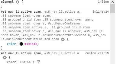

                It does not appear that my custom css code for the active menu is working? It needs to be fdf646
                Custom Code right now is: #s5_nav li.active span, #s5_nav li.active a {
                color: #fdf646;
                  Thats home page if you go to another menu item and move mouse to the right my menu text is black with the black background. I need it to be fdf646
                    dmgsupport
                    As I can see that you customize in custom.css file:
                        color: #fdf646;
                    you can change it to:
                        color: #fdf646 !important;

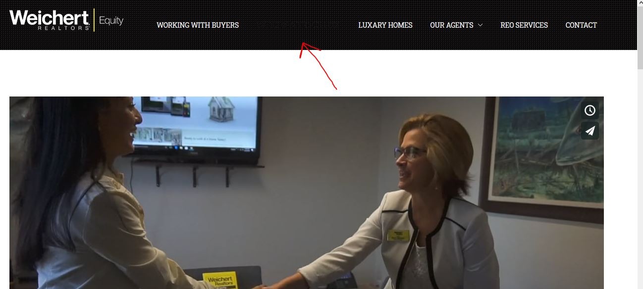

                    URGENT: I would like to just embed a video in the custom 1 position that works just like the picture does or your video in the demo (behind the menu). I need to embed instead of upload to save bandwidth and slow opening. I put in a premium ticket but that is slower in response than this. Hoping you are on line this morning as you at least respond. http://www.equityrealtyinc.com/ Thanks
                    When I embed it now it sits below the menu. Please advise on how I can do this. Here is the embed code. <iframe src="https://player.vimeo.com/video/451210501" width="1300" height="731" frameborder="0" allow="autoplay; fullscreen" allowfullscreen></iframe>
