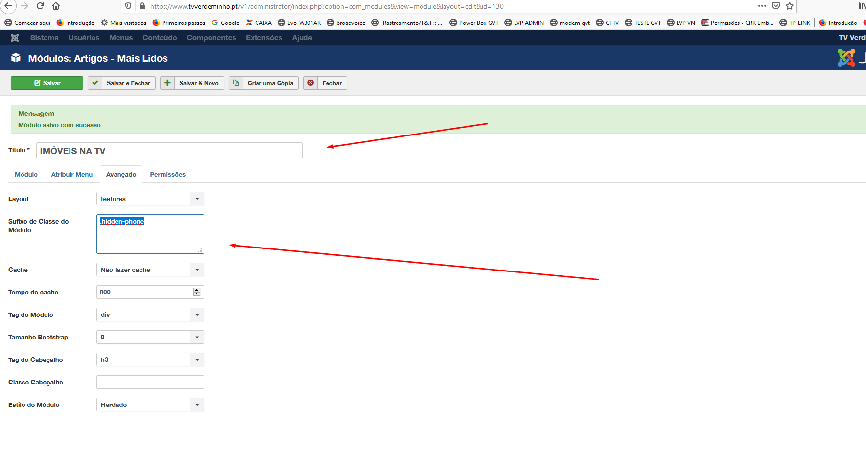

        You can use 'hidden-phone' class for the module that you want to hide on mobile
        From your screenshots, it seems that you use class suffix incorrectly. In 'Class Suffix' option in module settings, you should not use the dot before the class name, it should be 'hidden-phone' instead of '.hidden-phone'
        You will use '.hidden-phone' when you style css for it.

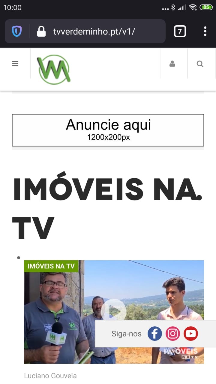

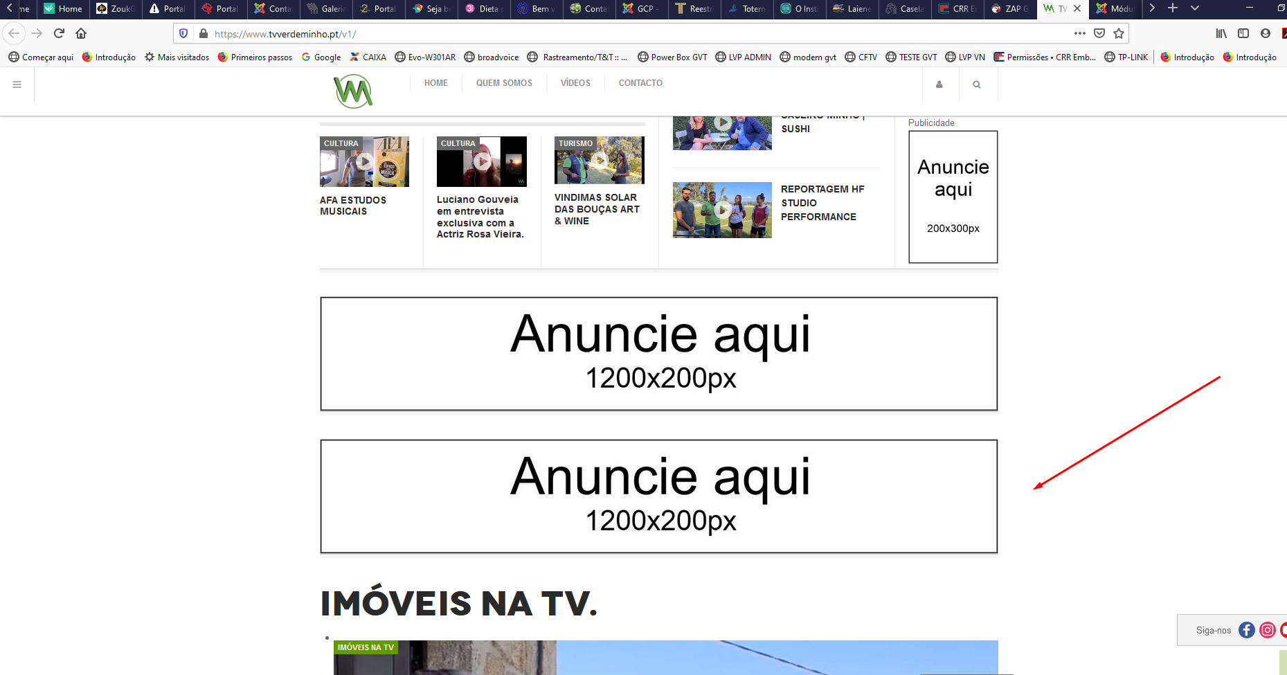

        Good morning, I added the code to show the position on the cell phone.
        then I added the code to appear on the phone.
        The module appears on the desktop (which was not supposed to happen).
        And it doesn't appear on the phone.
        I took the test on another browser. the position appears, but as I said above. The codes still don't work.
          scarlaiene
          Kindly check my last reply, you should not add the dot before the class name
          scarlaiene You should add a space before the class name also, I updated for you.
          Kindly check.
