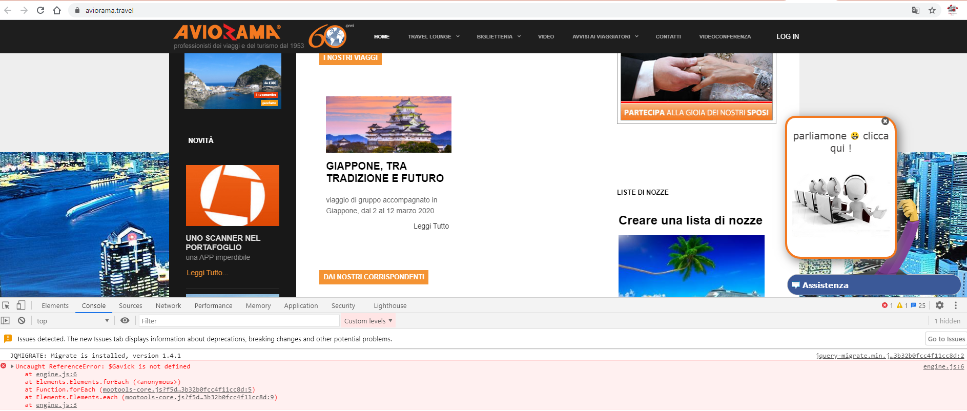

Dear friend, when going to use a plugin to compress and defer jawascripts (we use JSpeed which is the strongest and the newest of its category) to better the score at Page Speed and Yslow, we get erratically behaviour from GK 4 ImageShow. here you are as attached.
At moment, we had to disable the JSpeed plugin to avoid GK4 ImageShow blocked at all. Jspeed technicians have already examined their plugin settings, and found that the problem is at this error in motools of GK4 Image Show.

        I just tried to enable this JSpeed plugin on your site but I did not see error like screenshot in your first post: https://prnt.sc/uhzvaf
        Could you check again?
        you should leave JSpeed disabled and check the website, re-loading the home page 2 or 3 times and the error is visible in the browser console

          Yes I want to use JSPEED ! But it cannot work at its best capacity IF YOU DON'T CORRECT THAT PROBLEM on GK4 Image Slide Show. To see the error, you must follow the JSPEED technicians' advice: you must keep JSPEED disabled, check the website re-loading the home page 2 or 3 times and the error is visible in the browser console. If you don't correct this error (WHICH IS IN GK4 MODULE !!), some functions of JSpeed CANNOT WORK properly and, if enabled, BLOCK THE SLIDE SHOW. So please correct that error at your module. Thanks

            Hi GIESSE I've shared this to our developer for further investigation, somehow this error happens on your site specific as I can't replicate at my end.
            24 days later
            GIESSE
            After clear cache, the js error was gone. Please check.
