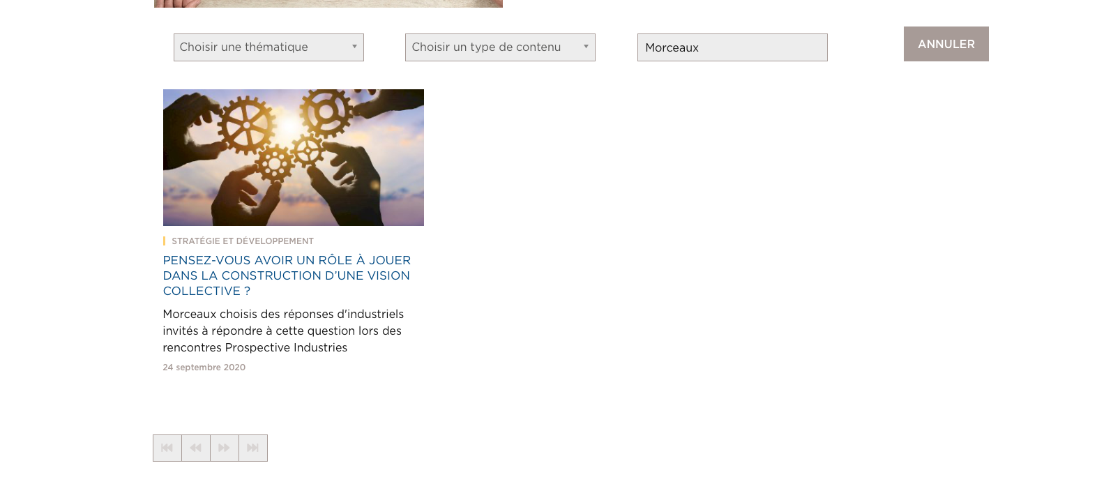

    Hi tomoe
    I tried to search and it shows correctly:
    and as I can see it's fulltext
    It worked because it's a word in the excerpt created by JA Megafilter. But if you search for a word in the text itself (for example GAFAM which is in 2 articles), nothing comes up.
