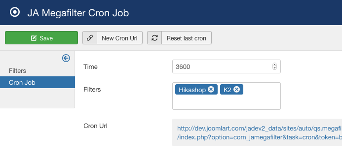

        Hi jschroeder
        Kindly check the component settings in admin panel of your site >> navigate to Cron job >> you can create new cron URL there + set the time + select the filter(s), you can send this url to your hosting and they can help to setup.

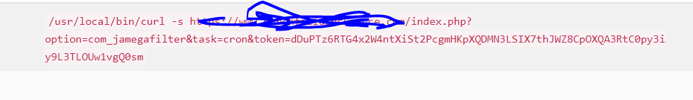

            I have tried using the command you suggested above and unfortunately it does not seem to work. I attached a screenshot to show a sample cron I did. I have tried with /usr/local/bin/curl, with /usr/bin/curl. I don't get what I am missing or doing wrong. I wish there was documentation of the exact path and what needs to be in the cron because I just cannot get it to work. Do you have any idea what is going on?
              jschroeder
              Please wrap your cron url in double quote
              Ex:
              curl -s "https://joomlart.com/cron.php"
