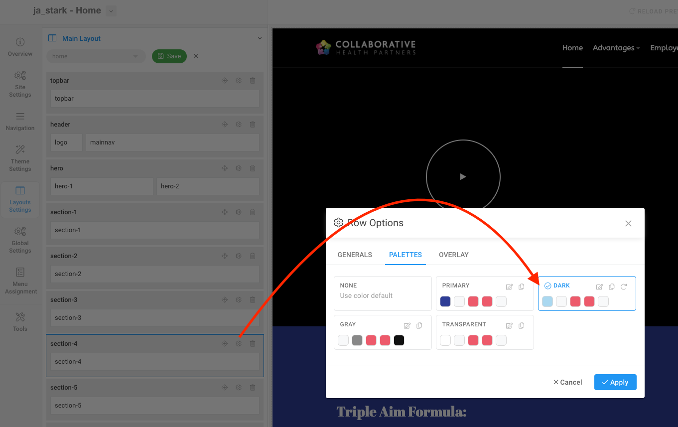

            I tried to take a backup of your site to debug in my local, I tried to delete a section like topbar but it saved correctly. I meant the topbar section was removed completely.

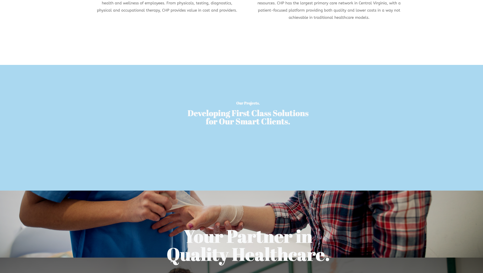

            Next, I tried to change the background color of section-4:
            the frontend shows correctly:

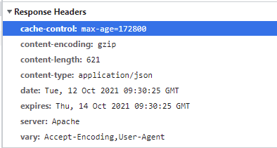

                saguaros figured out the problem and the template styles are finally being saved. I added the instructions here in an attachment for anyone else who finds this thread. We've been working for DAYS on this, and everyone involved has been very kind, and dedicated to figuring out why the template changes weren't being saved by T4 Framework.
                All I did was send the attached file to my hosting company and they made the requested changes. T4 is able to save template changes now.
                Thank you!
                  cityhomestead Actually, when clicking the save button in template, your changes are already saved but due to this cache control, you don't see the changes.
