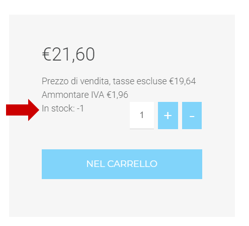

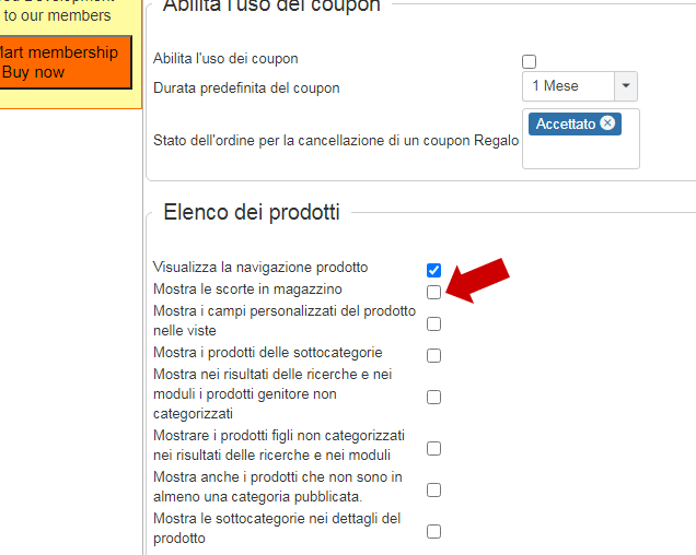

    2. Inoltre ho tolto la visualizzazione delle scorte di magazzino ma continuano a vedersi come da allegato.Ho pulito la cache ma rimangono sempre li, sia le scorte che la scritta Array che non dovrebbe proprio esserci!

      2. I have also removed the display of the warehouse stocks but they continue to be seen as per attachment. I have cleaned the cache but they always remain there, both the stocks and the word Array which should not be there!

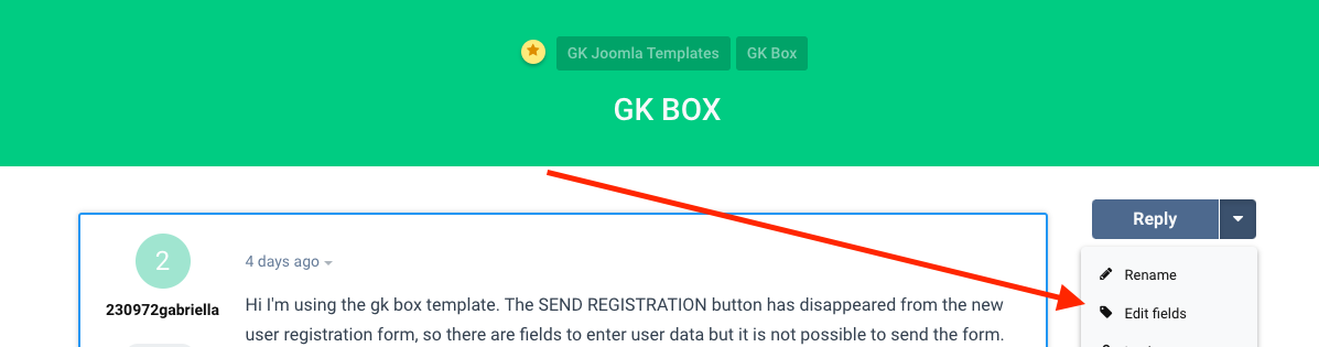

        Yes, it's better with a closer look at your site, kindly share the credentials of your site by editing Fields in your first post so only Moderators can see.
        Updated:

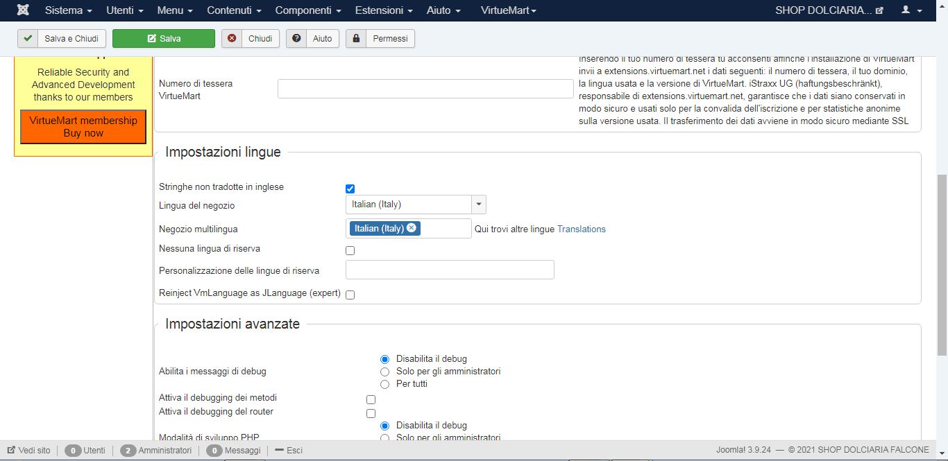

        As for the VM settings, I set the shop in Italian but it continues to be in English.
        I am attaching the screen

          • 2) correction of "Array" and "In stock:" on the product detail page as shown in photo n.1

              Hi 230972gabriella
              In the file: /templates/gk_box/html/com_virtuemart/productdetails/default.php
              This section caused that issue so I commented it:
              // if (is_array($this->productDisplayShipments)) {
              //     foreach ($this->productDisplayShipments as $productDisplayShipment) {
              // 		if(trim($productDisplayShipment) !== '') {
              // 			echo $productDisplayShipment . '<br />';
              Kindly check
