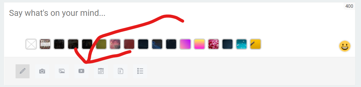

        3) Click the 'video' icon underneath the new wall post field
