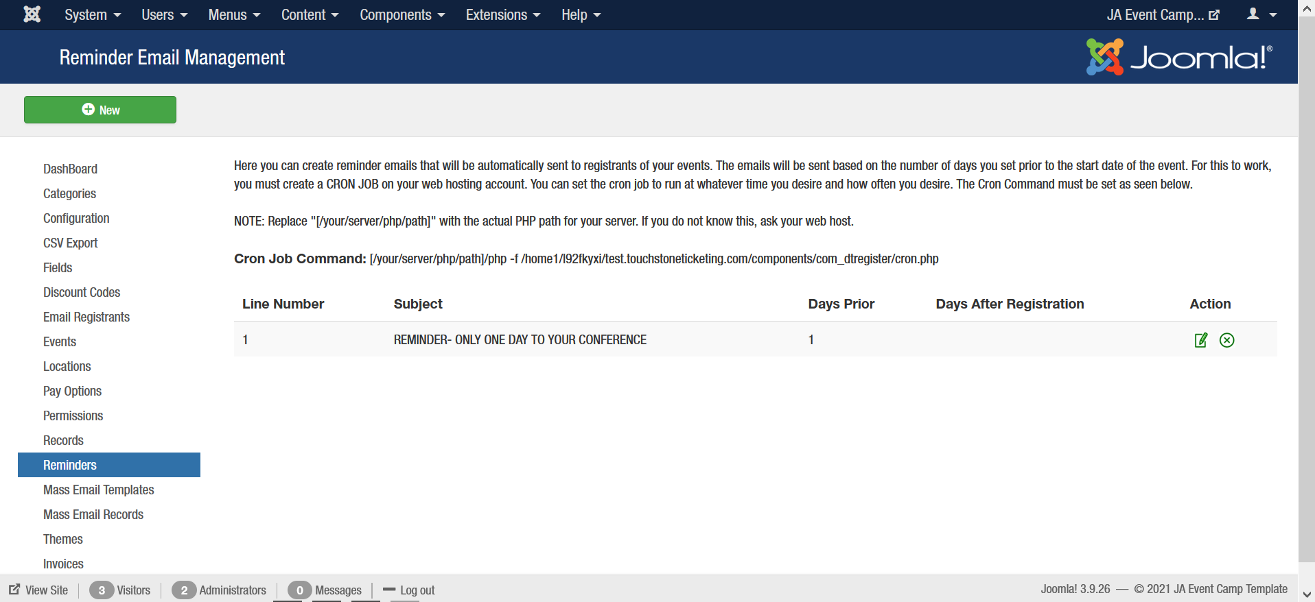

I have set up a test site for development and was trying to set up a cron job based on the instructions on the Reminders set up page as shown on the screenshot below.

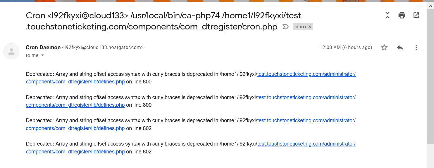

I did as instructed to set up the Cron Job command on my server and also set up a test reminder. The reminder was set to go at 12 midnight last night and I got the messages from the server that are shown on the screenshot attached.
Please check to see what might be causing this problem.
    Hi micon6
    This deprecated messages appear in PHP 7.4, I've reported to team to fix this.
    Will keep you posted.
