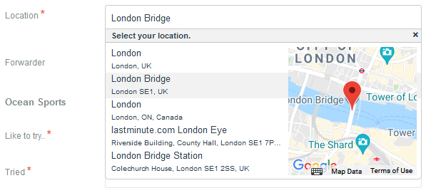

    Thank you Pankaj - that was indeed the problem - I have added Places and the drop down now populates as you can see:
