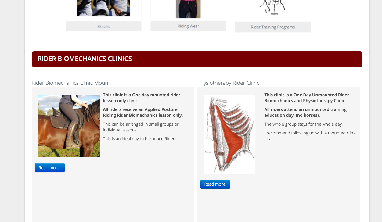

    Hi saguaros I've updated the ticket details with an admin login for you.
    I've just re-confirmed that re-publishing Zentools2 causes the '0 - call to member function' error, unpublish it and the site loads ok.
    Just go to Extensions > Manage > Manage to toggle away and see the results.

      martinbeaumont I checked your site in my local environment but it worked with Zentools module enabled. It seems happen on your server specific. Kindly wait pls.
      The issue caused by a 3rd party extensions on your site: System - Membership Schedule Content
      Our developer updated the file: /modules/mod_zentools2/includes/joomla.php
      to fix the issue.
      It should work now, kindly check.
