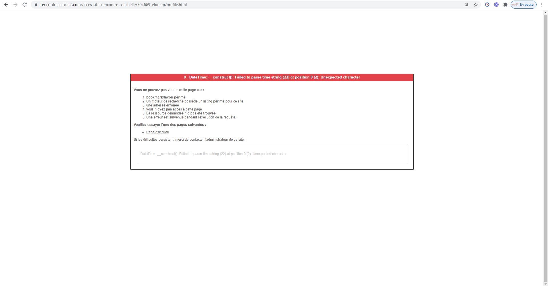

by personalizing the profile of the member I realized that in selection "date of birth" in the back office the profile of some member displays an error. see attachments.

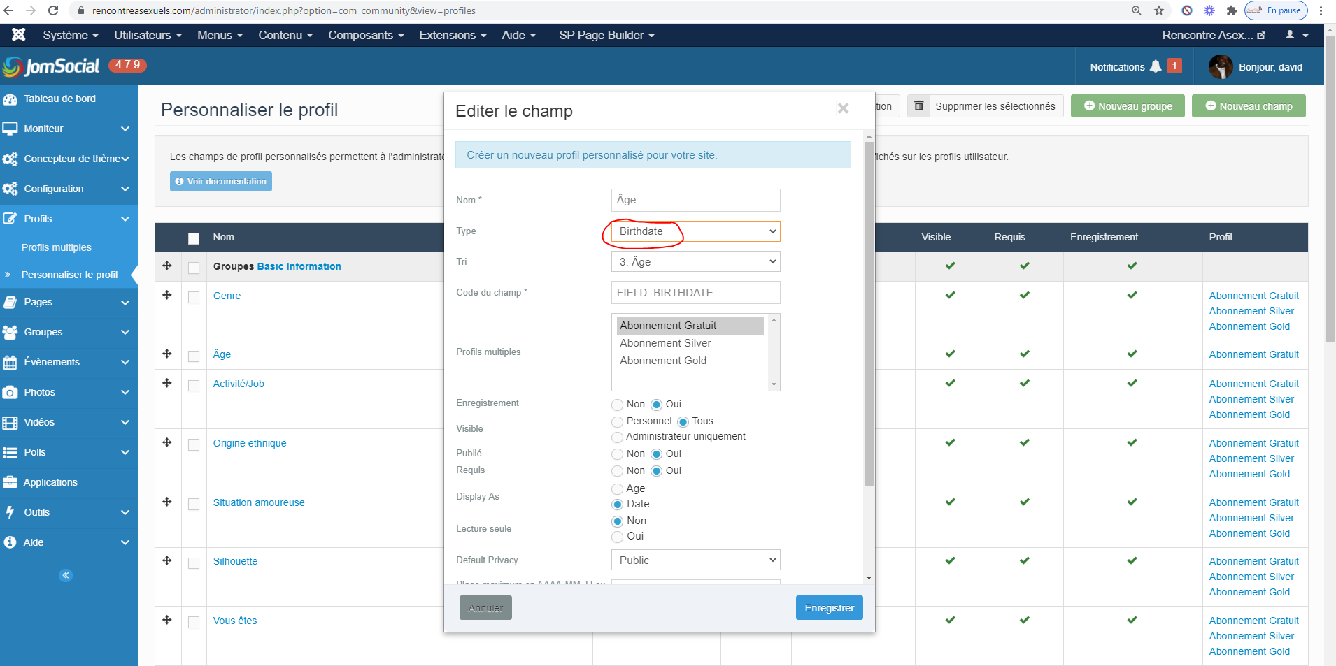

when I put "date of birth" several member profiles present this error

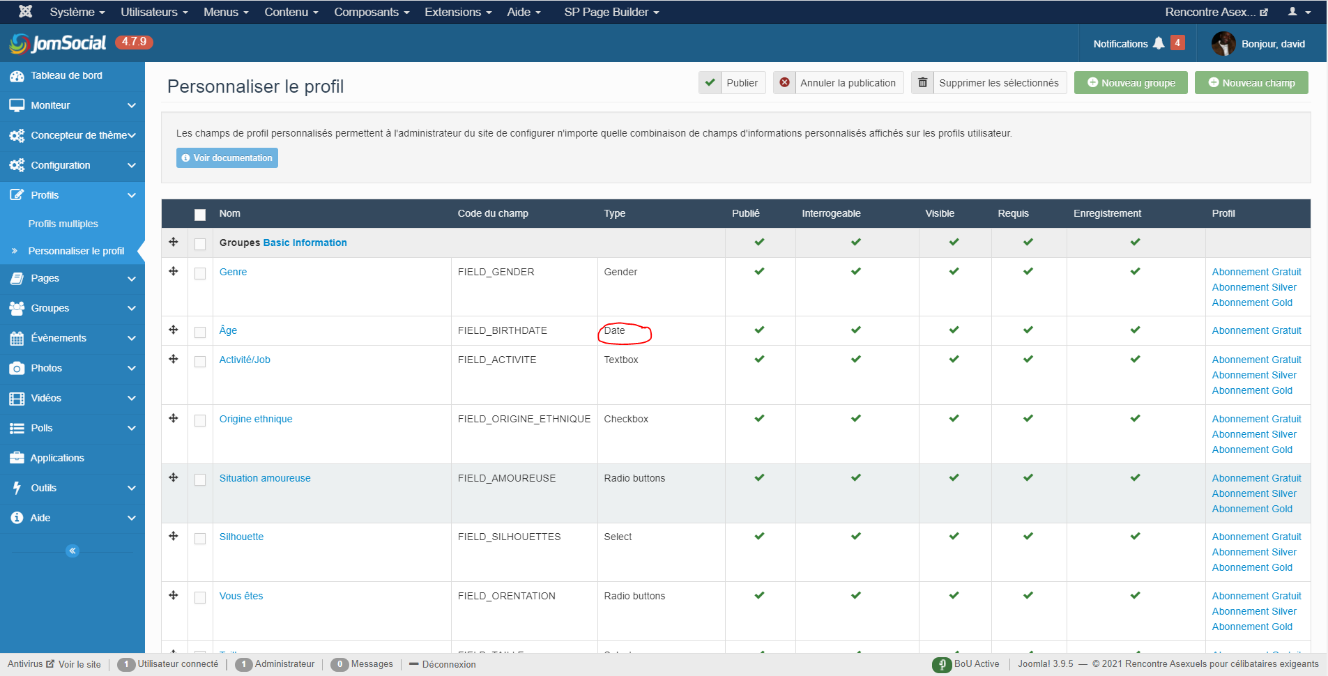

but when I modify by putting on "date" the error disappears from the profiles but it is not the age which appears in frontend

Please provide a member username or profile URL which has this issue,
Possibly you have the DB issue on site for some members if they imported on site and not saved data via profile.
Domino or Valentine4271
contact-davidlissparis-com
Both users missing the Age field in profile : http://prntscr.com/1qkvnz4 http://prntscr.com/1qkvplx
Kindly add it and check.

There is nothing happened auto, possible on your site admin you changed the field types that already in use of many members that result the issue as you already using a different filed type and after that it is not added as new.
If you want to change the field you should make a new entry as users already using that. I am not sure what was in previous as you already changed it on site.
Thank you for your explanations, I have another question, when I modify the field by replacing "birthday date" by "date" the profiles are displayed correctly, on the frontend but it is not the member's age which appears but the date of birth (example 12/03/1979) except I wish that (42 years) appears on the frentend.
It's possible?
Each fields type is different and would not work same.
On this i will check with dev team if there is possible option or switch the formate as you needed.

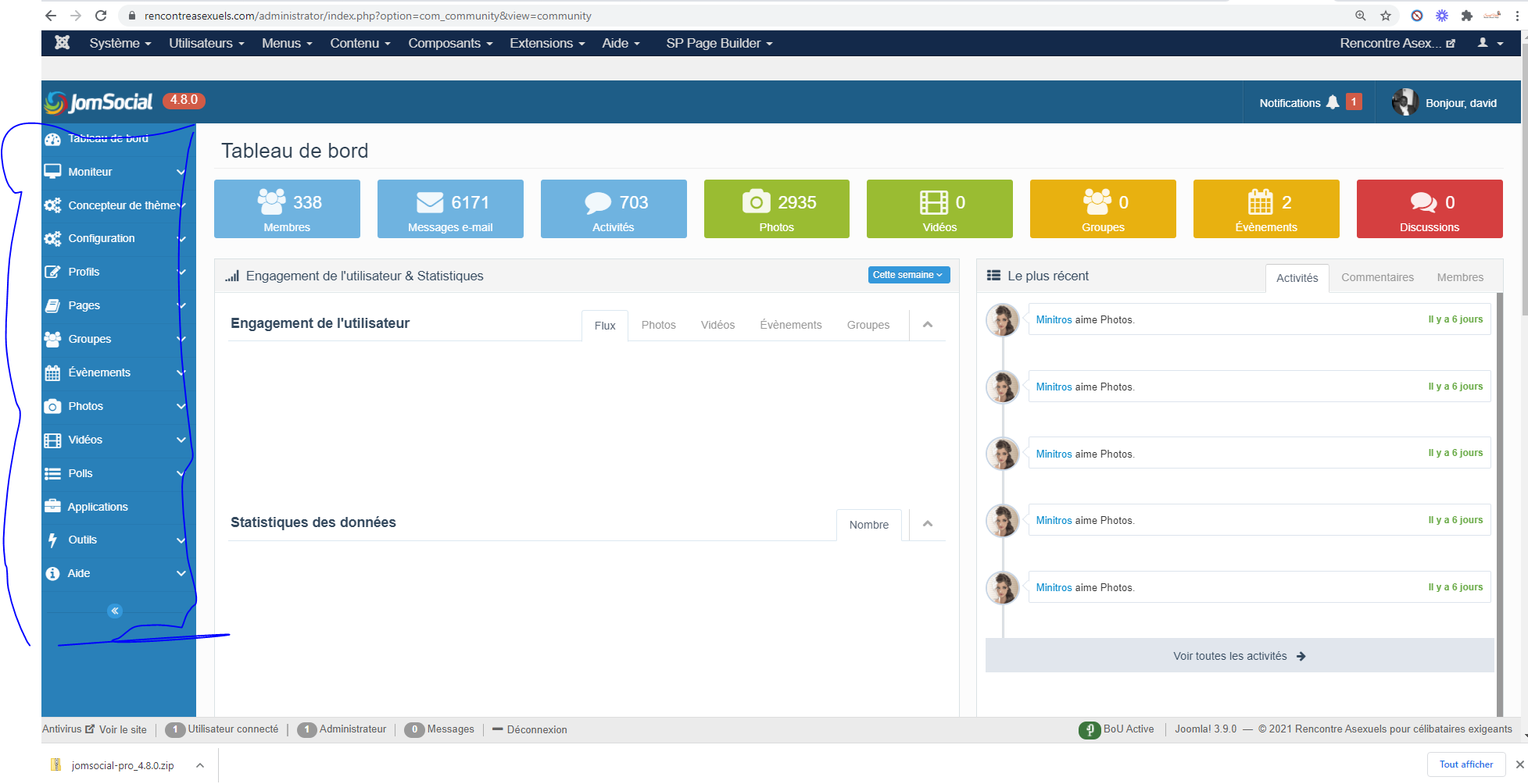

I updated to 4.8.0 and from the side menu does not work.
Can you make a separate post as the topic is different. on backend it can be conflict. Please make a new thread with working site super user login for staff.
