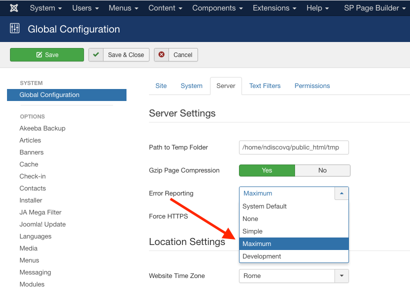

    Once this value is changed, you can test the index of the filter and remember to enable the Error Reporting in Global Configuration - it will show the error if it happens again:
