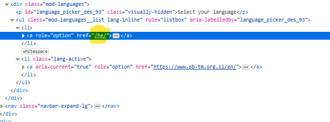

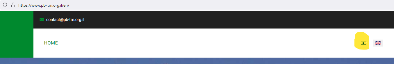

The route for Remove URL Language Code for default lang is ok but the the links are wrong
See links in the lang module(https://www.pb-tm.org.il/en/), the uri link for hebrew the defualt lang is wrong
should be "/" https://www.pb-tm.org.il (def lang)

301 redirctions are not the best solution ...
the best solution is to place the correct url navongol
    navongol

      In j3 is the same url, but was 301 Redirections.
      The best practice is to set a correct url for the Remove URL Language Code settings
      "/" for def lang and /xx for other without 301 redirections
      navongol Is the same on both
      If the issue remain same on the Joomla default templates i suggest you to post the issue on Joomla forum as the Joomla 4 updates is complete change in UI and codebase, So Joomla team can have a look on the issue.
      You can mentioned the steps with Joomla 4 default template on Joomla forum.
        I did 301 redirections for now.

        I see its known issue and already raised by other Joomla members, You have to wait followup on the same post for its fix in new Joomla updates.
