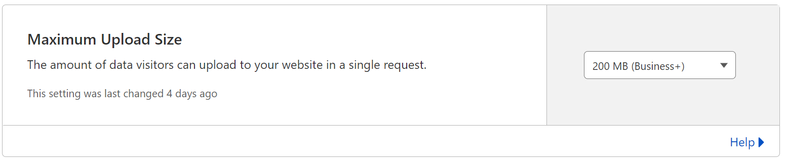

@manhta I verified that this problem exists when the CloudFlare maximum is set to 200 MB as seen in the following image:
(Tested with chunk size of 150 MB.)

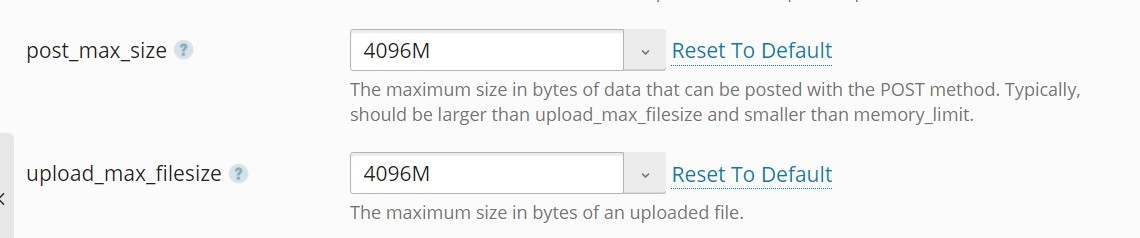

manhta Server config is as follows:

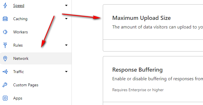

- I set up CloudFlare on the test site, and subsequently the problem appeared. CloudFlare is configured as follows:

radiosteve verified that this problem exists when the CloudFlare maxi
You have to increase the max upload size in your Cloudlflare setting as it restricted with 200MB max.
Also increase max execution time value to 300.
If the issue remain same can you disable cloudlfare cache and check as this limit of 200MB could not be override via Jomsocial for cloudflare cache.

manhta You tested a 188MB file (which is bigger than the chunk size of 150MB, but smaller than the CloudFlare limit of 200MB ), but the problem is that files larger than the CloudFlare limit fail. And @Ninja said I have to increase the CloudFlare limit. But what would be the purpose of splitting the upload into smaller pieces if the CloudFlare limit must be increased to cover the total combined size anyway? I believe large files (>200MB in this case) uploaded through the activity stream postbox should be split into chunks and should succeed, even with the CloudFlare limit at 200MB, as it works from the profile/My Videos upload window! Please clarify.
