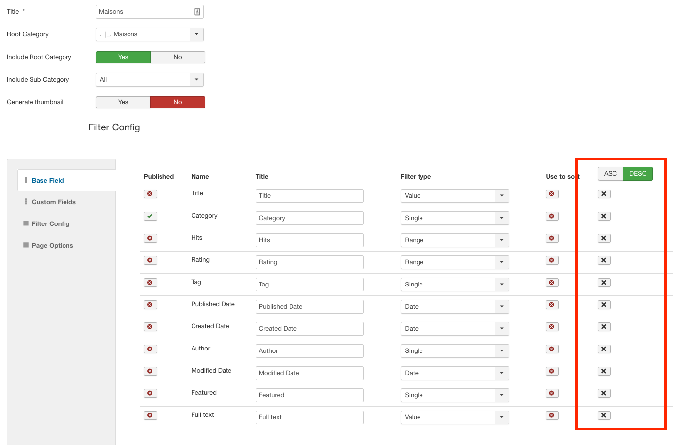

Hello How can change the default sort by position instead by title
Thank you
    Hi kinui
    You can open a filter and select a field to sort by default:
    Hello, Yes I know that I can do that but how can I change the default value of sorting when the page is loading, is always the title and there is no Position or Order option in the base field tab (the same as the picture you send) even if there were this option is not sorting the products by the order of the articles, it sort the articles by the ID of the article
    Also I implemented a custom field to sort when the page is loading for the first time, but it takes always the title as I mention before. I tried to remove the title for sorting an then the default is the position and have the same problem I don't have the option to disable this sorting.
    How I can change the default sorting option when the page load for the first time? I will use the custom field that I mention before.
    Thanks for your help

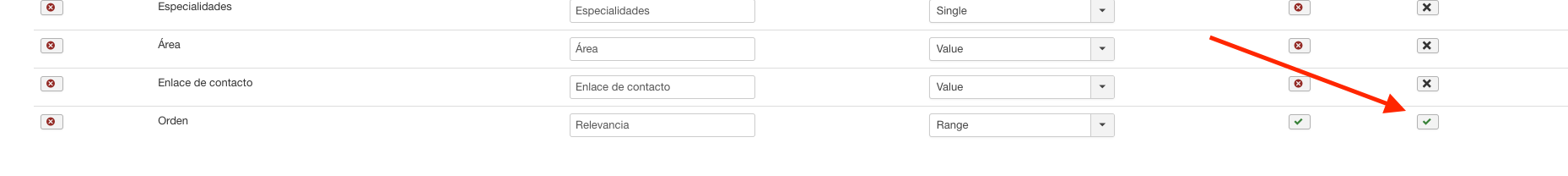

      kinui You should check the last column to set it as default order:
        Hi saguaros , thanks a lot for your help actually that was the configuration I was looking for.
