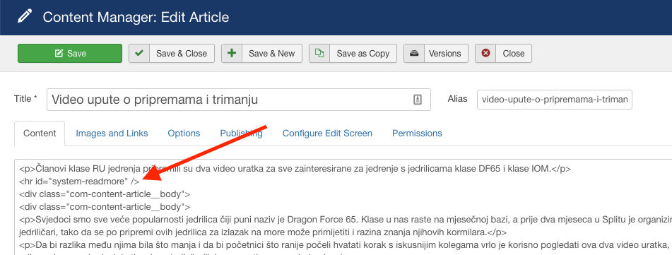

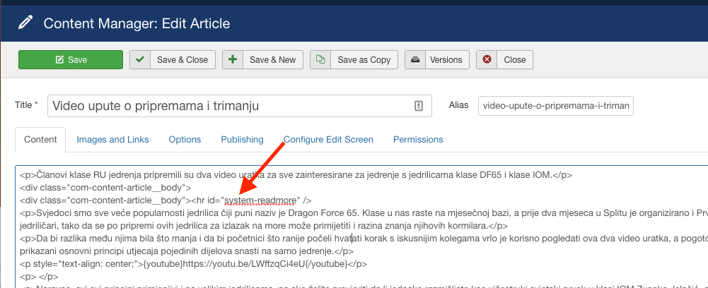

        When I found articles, I will check HTML markup in content and see that the readmore is placed in wrong position, you should not put inside a div tag like this:
        You should put the intro text (first paragraph) first + then readmore button + and finally fulltext.
        As you can see 'RU jedrenje' page is showing fine now, you can apply the same for other pages. And pls note this when creating articles.
