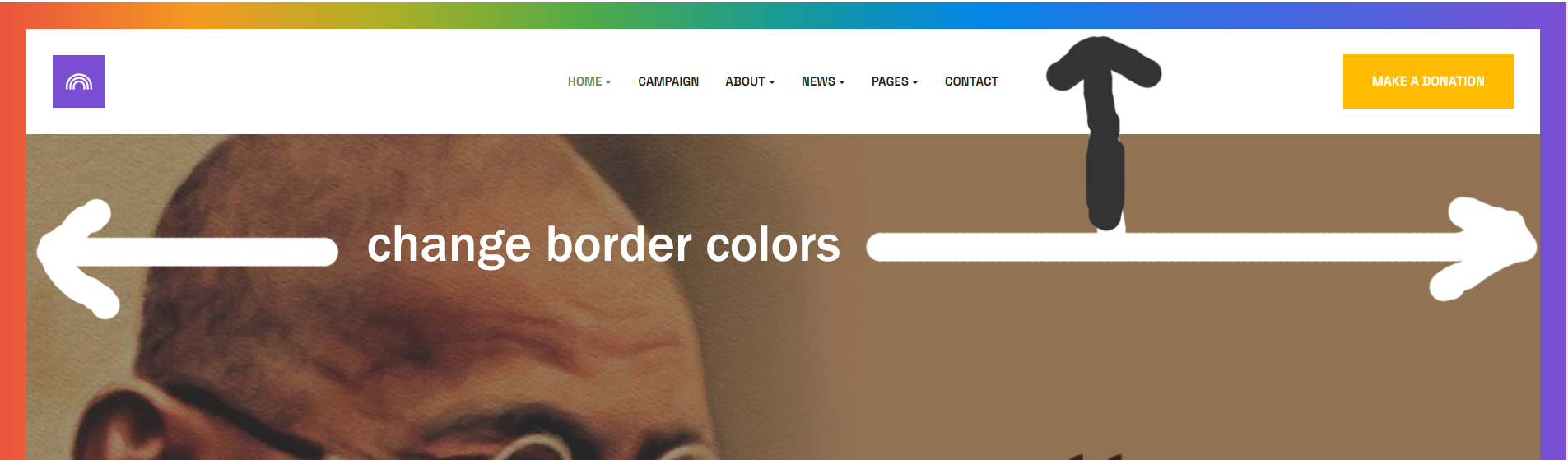

I saw an answer: Hello
You can override it via a custom css file with the code below:
.t4-wrapper {background:#fff!important;}
but the problem is I can't find the t4 wrappercodes. I want a border but with different colors. Where can I find the codes to change the colors
Another addition: Where can I see the existing codes as an example to create new codes with different colors.

      You looked at my old site and not at the subdomain: http://extra.bronvanliefde.nl/ Your answer spans the width of the screen. This problem is known to me. The site is now almost 10 years old and is in need of an update. That's why I'm looking for a new template with Joomla 4.
      Back to my earlier question. If you look at the sent photo you will see that I want to define the different colors differently. Can you give me the code for an override to adjust the different colors to my choice.
        bojon49
        here is code that used at the moment on your site
        div.t4-wrapper {
            background: -webkit-gradient(linear,left top,right top,from(#ea533d),color-stop(#f49a22),color-stop(#abaf27),color-stop(#50ab47),color-stop(#189a95),color-stop(#0286e6),color-stop(#306fe2),color-stop(#5061dc),to(#7a4ed3));
            background: -webkit-linear-gradient(left,#ea533d,#f49a22,#abaf27,#50ab47,#189a95,#0286e6,#306fe2,#5061dc,#7a4ed3);
            background: -o-linear-gradient(left,#ea533d,#f49a22,#abaf27,#50ab47,#189a95,#0286e6,#306fe2,#5061dc,#7a4ed3);
            background: linear-gradient(to right,#ea533d,#f49a22,#abaf27,#50ab47,#189a95,#0286e6,#306fe2,#5061dc,#7a4ed3);
            -webkit-animation: rainbow 18s ease infinite;
        It is combination of different colors for rainbow view . Add this code in custom css and you can override the color values.
