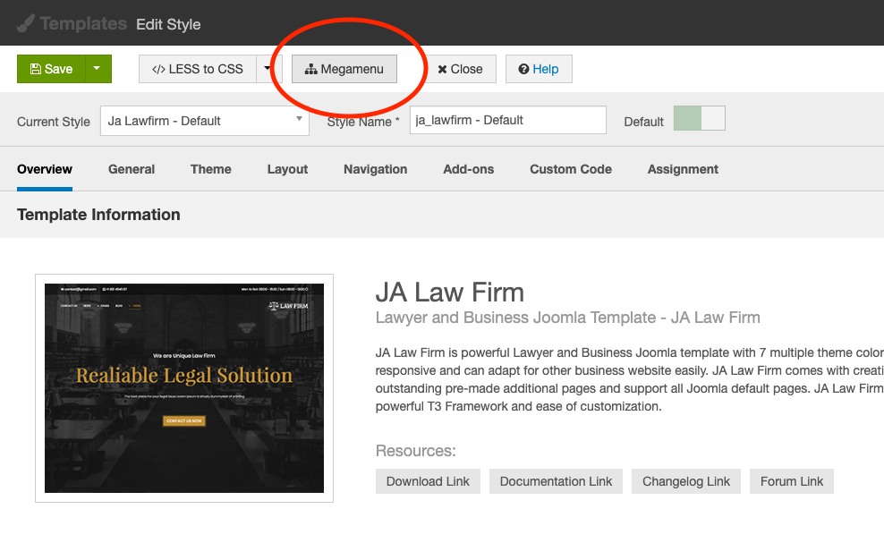

    You can go to template style of JA Lawfirm template >> hit the 'Megamenu' button to navigate to Megamenu Configuration:

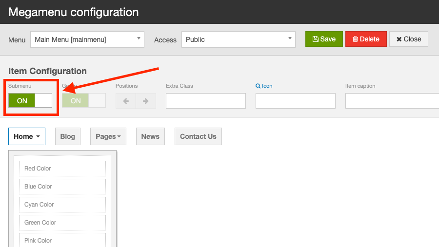

    Then select the 'Home' item and switch off the 'Submenu' option:
