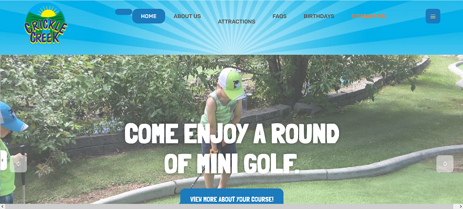

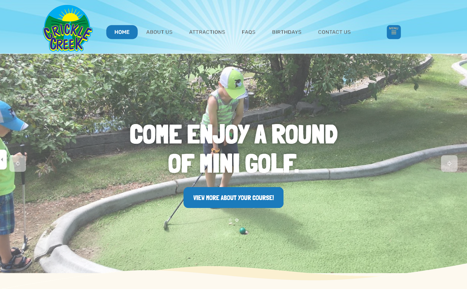

I would like the company logo to be inline with the menu as seen in the attached image. I edited the mainnav.php file like suggested in a previous post, but I can't get the menu to be in line with the logo. Can you please let me know what I need to do to make this happen?

    Thank you for the reply. That worked some, but Attractions is now bumped down - as seen in the attached image. Also do you know why there is a bit of blue coming off the home button?

            It due to your custom logo in 'mainnav.php' block, it's missing a closing tag and caused the issue.
            It's working now, kindly check.
