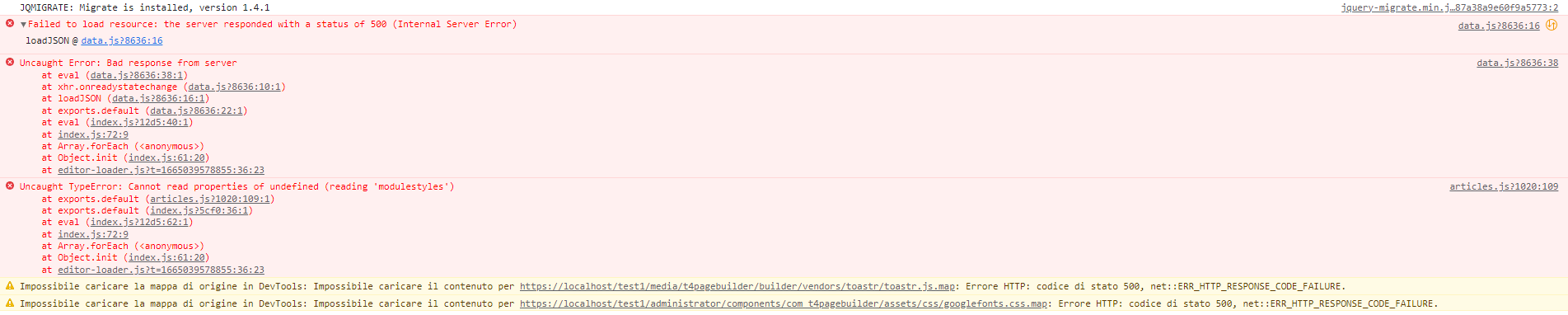

Using the Chrome Inspector tool (console) I have a number of errors (I attach screenshots).

    editor-loader.js?t=1666881701461:12 Uncaught SyntaxError: The requested module './editor-config.js' does not provide an export named 'pageBlankMesg' (at editor-loader.js?t=1666881701461:12:53)
    DevTools failed to load source map: Could not load content for https://www.MYDOMAIN.COM/media/t4pagebuilder/builder/vendors/toastr/toastr.js.map: HTTP error: status code 404, net::ERR_HTTP_RESPONSE_CODE_FAILURE

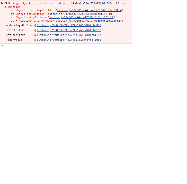

        ](https://) This is the other error when using the joomla article editor and then trying the "toggle to t4 editor" button.
