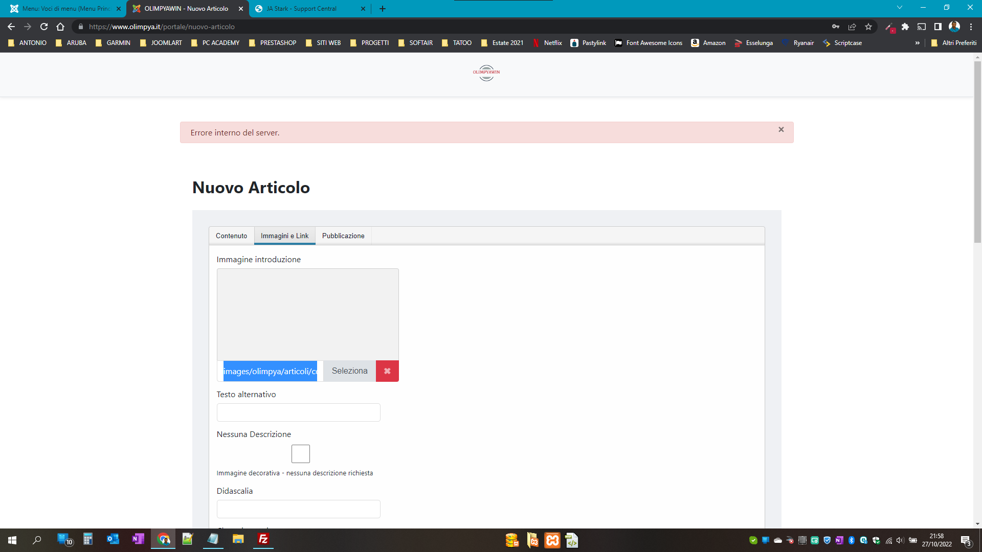

when I try to upload an image to an article from the images and links tab from the front office I get an error and the image is not published. How can it be resolved?
Thank you
joomla 4.2.4

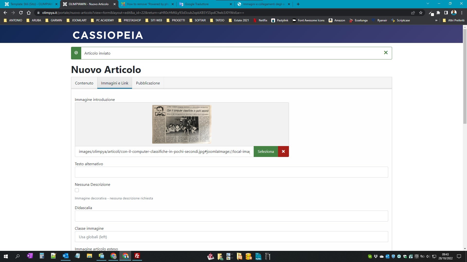

Could you try to switch default Joomla template - JA Stark - to use Cassiopeia template and see how it goes?
    saguaros
    Thanks for your interest,
    with cassiopea everything works perfectly.

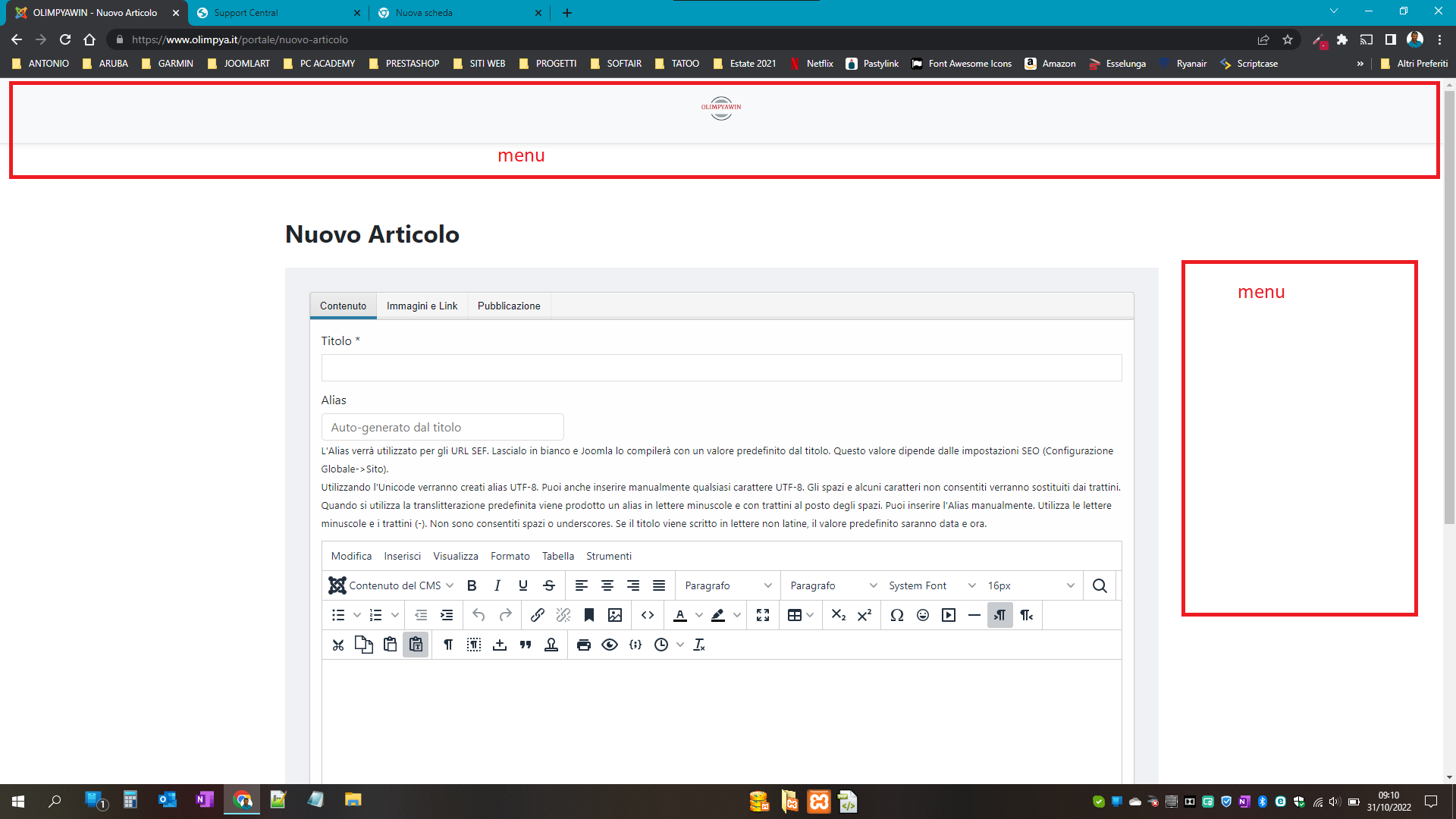

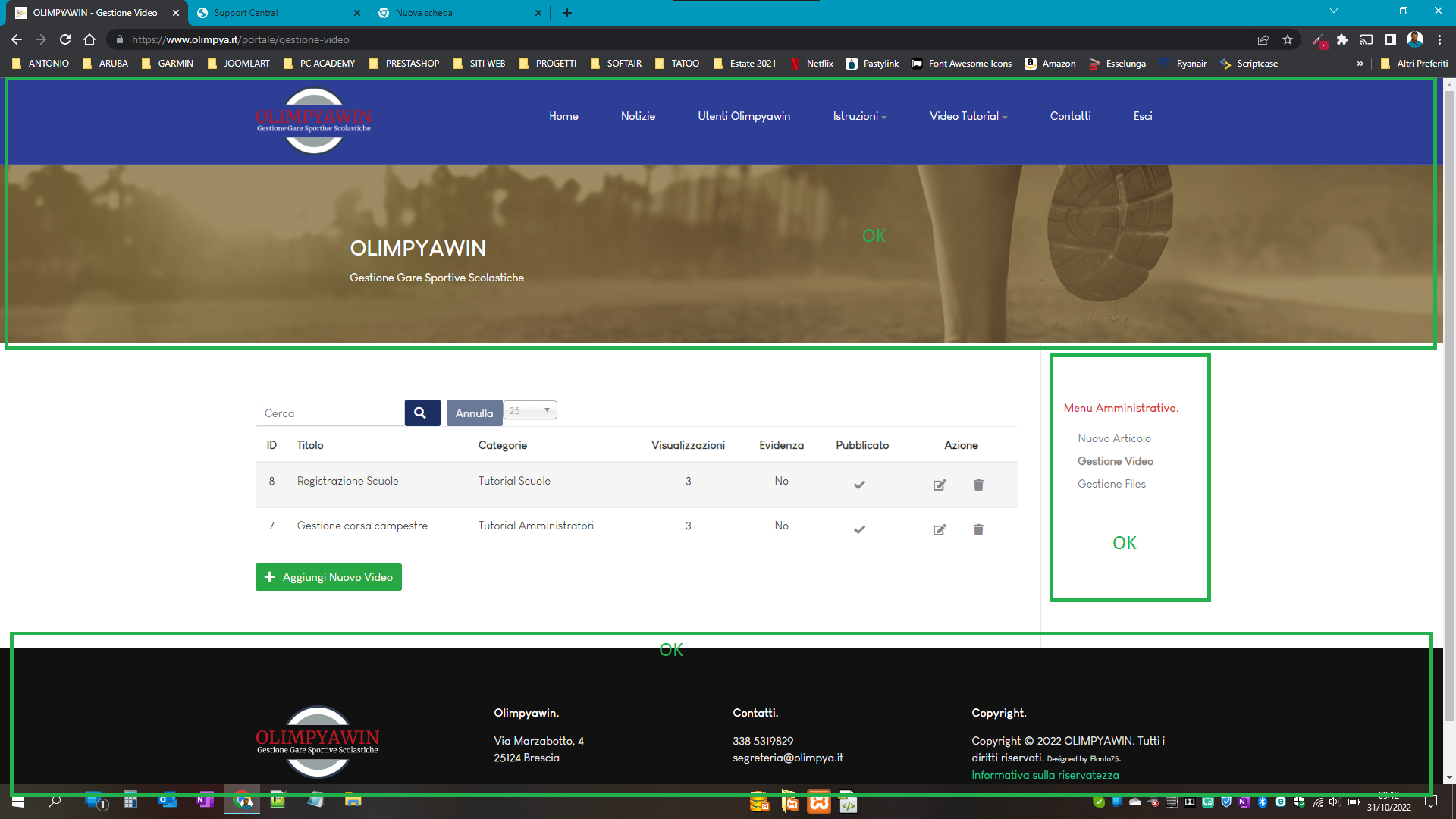

      Thanks for your invaluable help but it still seems something is wrong.
      when I click on the menu item "Nuovo Articolo" it seems that the page completely loses the layout of the JA Stark template and that the modules of the "Menu Principale" and the "Menu Amministrativo" are not published either.

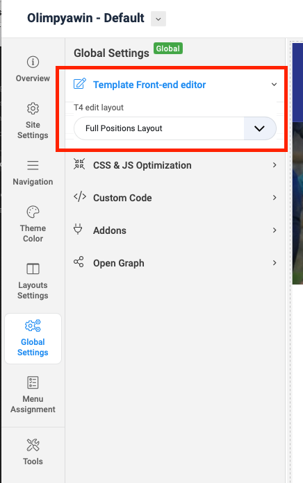

      It relates to the 'Edit layout' settings in template, not relate to the fix I applied above.
      You should check carefully again.
