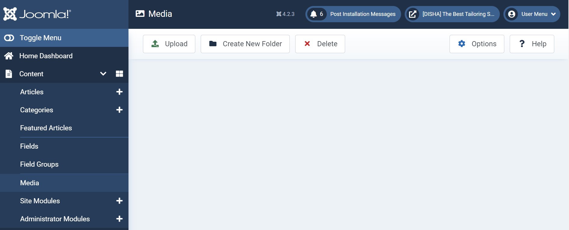

Hi, The Joomla media manager is not working. When debug mode is on it is working. But when the debug mode is off it is not working. I am attaching screenshot. This is with educatsy template

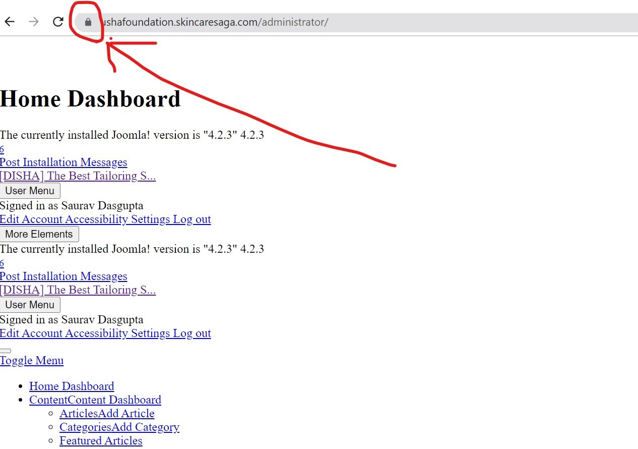

When I am using http it is working fine. Things are not working when using https. Can you check

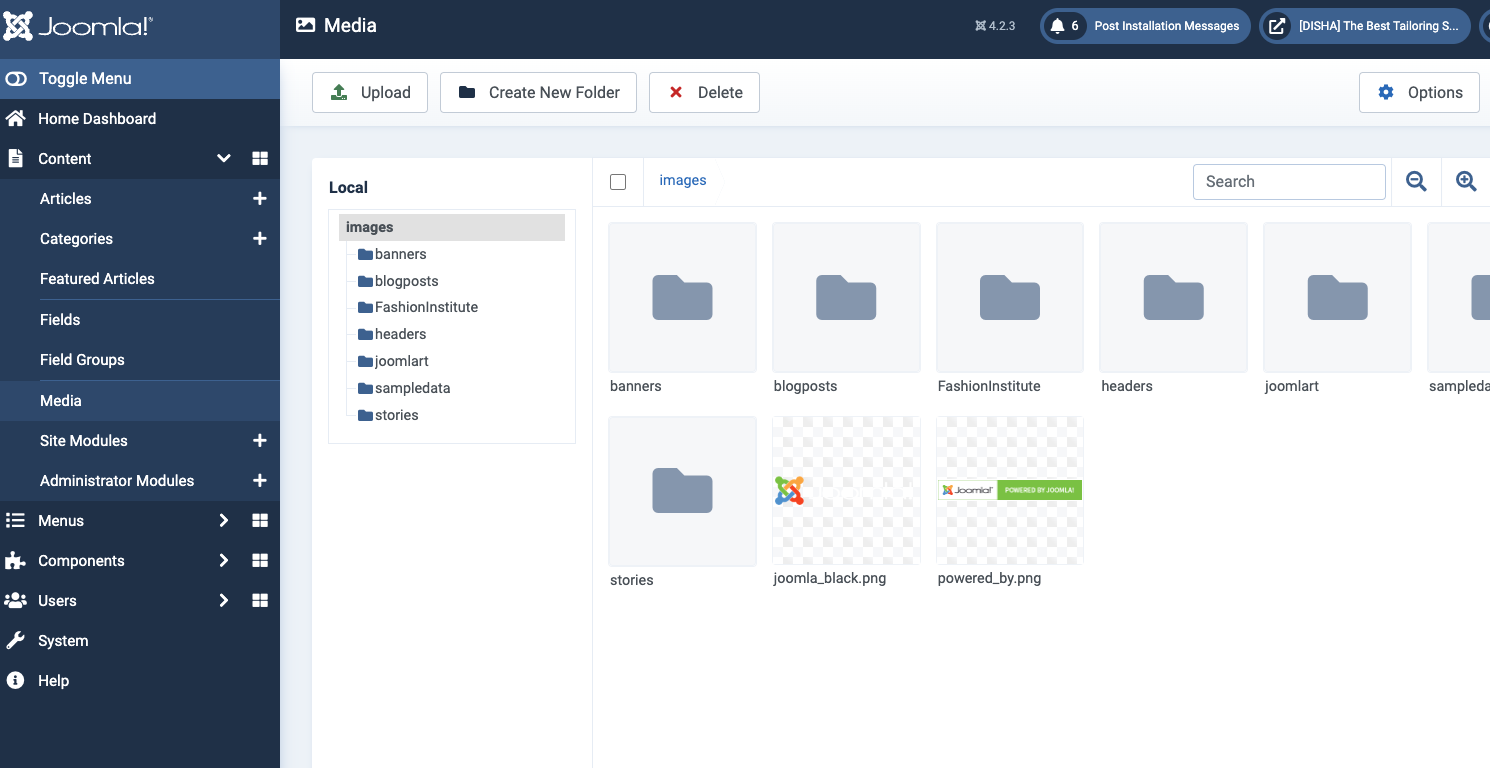

I just enabled Debug mode in Global configuration but I still can access Media manager normally.

Hi, Access https://ushafoundation.skincaresaga.com/administrator/ not http://ushafoundation.skincaresaga.com/administrator/ if you use HTTPS then the whole admin panel is not working. Please check once. In think in HTTPS mode some javascript and css files for admin panel is not loading. I have added a screenshot, how the admin panel is opening in https mode.
I think it relates to the rule in .htaccess file on your site, pls backup your site and try the solution here: https://www.joomlart.com/forums/d/40899-administrator-page-going-wrong/11
