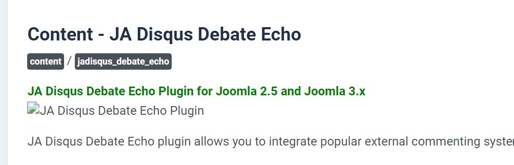

The disqus and debate component is said to be joomla 4 compliant but when I installed it, the comment says that it is only 2.5 and 3 compliance.
    Hi sauramon
    Maybe our dev forgot to update the description of this plugin, is there any issue when you use with Joomla 4?
    Not yet used. Only installed. I will let you know.
    According to the change log, it was updated to be J4 compatible at version 2.6.5 (August 2021)with the latest release being 2.6.7 (April 2022)
    I have just tested it and all appears to be working well. Seems that just the comment in the language file needs changing.
