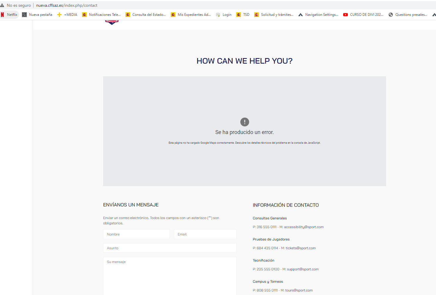

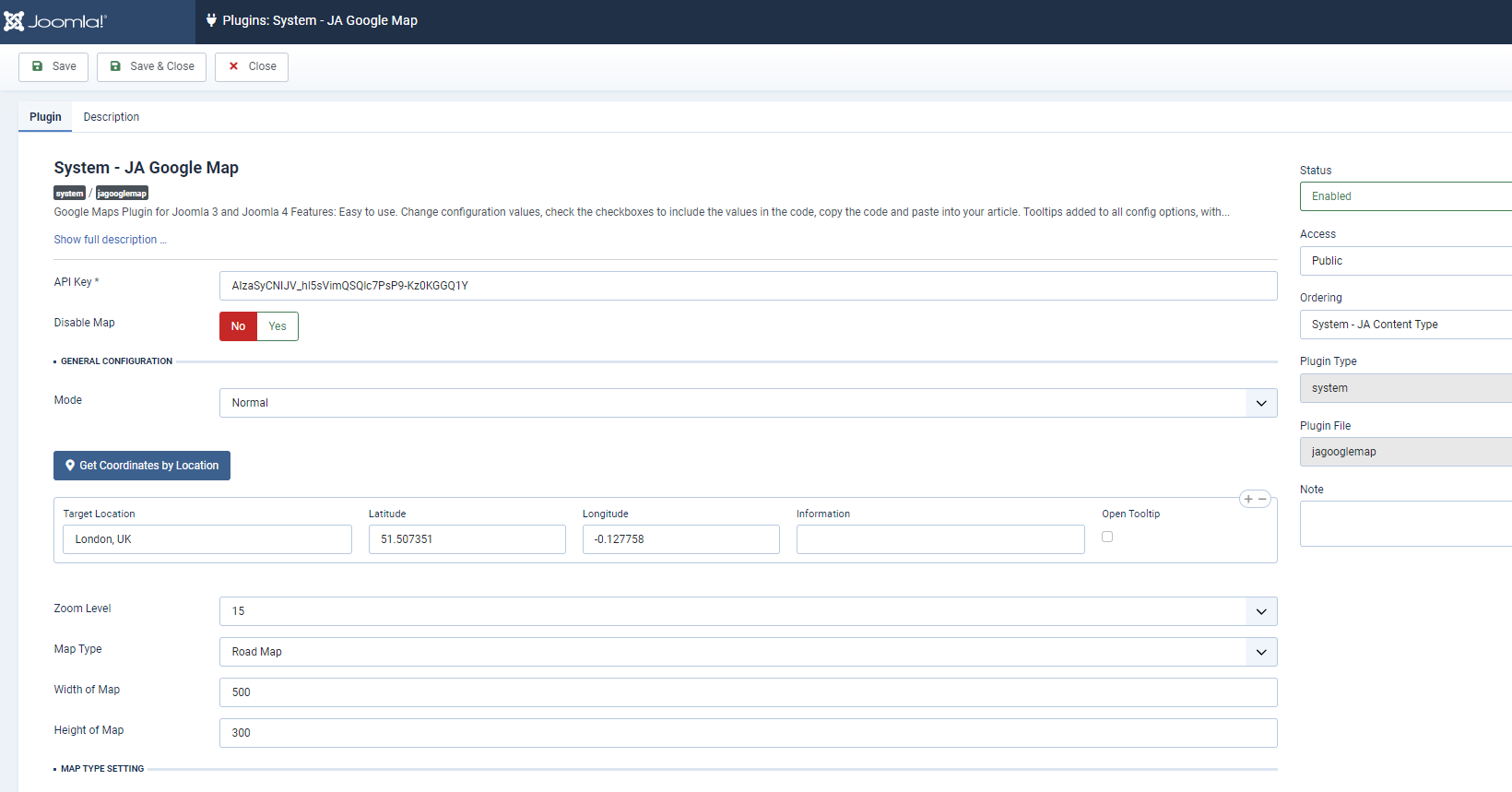

Hello I don't know the reason why the JA Google Map plugging built into the template doesn't show the map. I have installed the template locally and it works locally. I do not know the reason. Could you give me some idea to solve it? Into plugging press preview Thanks in advanced
HI I get this error An error has occurred This page has not loaded Google Maps correctly. Find out the technical details of the problem in the JavaScript console. I attach the info. Thanks
The console reports the following:
JQMIGRATE: Migrate is installed, version 3.3.2 js?key=AIzaSyCNIJV_hl5sVimQSQlc7PsP9-Kz0KGGQ1Y:216 Google Maps JavaScript API has been loaded directly without a callback. This is not supported and can lead to race conditions and suboptimal performance. For supported loading patterns please see https://goo.gle/js-api-loading oea @ js?key=AIzaSyCNIJV_hl5sVimQSQlc7PsP9-Kz0KGGQ1Y:216 maps.googleapis.com/maps/api/mapsjs/gen_204?csp_test=true:1 Failed to load resource: the server responded with a status of 403 (Forbidden) js?key=AIzaSyCNIJV_hl5sVimQSQlc7PsP9-Kz0KGGQ1Y:82 Google Maps JavaScript API error: RefererNotAllowedMapError https://developers.google.com/maps/documentation/javascript/error-messages#referer-not-allowed-map-error Your site URL to be authorized: http://nueva.cffsaz.es/index.php/euro-blog/76-bernd-leno-fulham-sign-goalkeeper-from-arsenal-in-8m-transfer-deal _.Fe @ js?key=AIzaSyCNIJV_hl5sVimQSQlc7PsP9-Kz0KGGQ1Y:82 DevTools failed to load source map: Could not load content for http://nueva.cffsaz.es/media/vendor/jquery-migrate/js/jquery-migrate.min.map: HTTP error: status code 404, net::ERR_HTTP_RESPONSE_CODE_FAILURE
Hi Please close this case. The problem was in the restriction of my Google Maps API. sorry i opened the post Thanks
