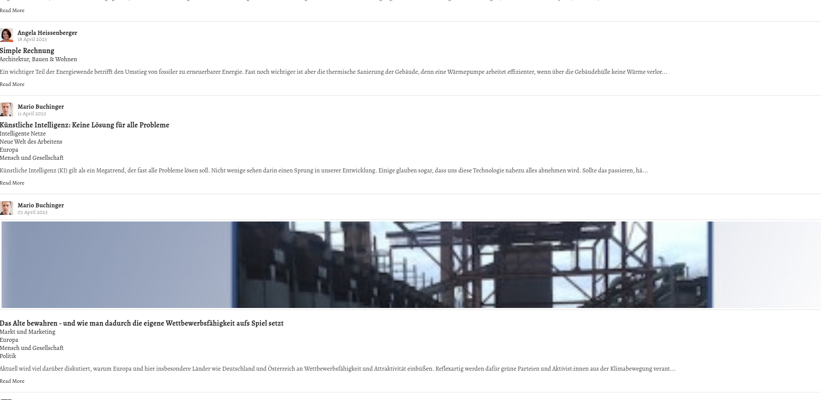

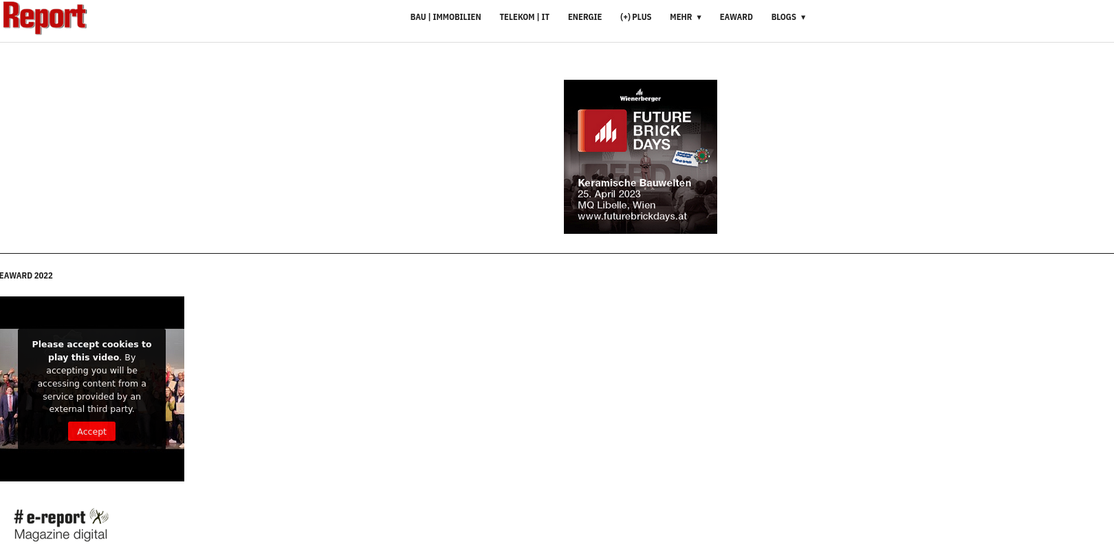

        Had the same problem a couple of weeks ago. Template layout completely broke after update. The issue then was attributed to using php8.1 ....Now I see that the issue also occurs on earlier versions of php.
        Is there a timeline, when this issue will be fixed?
        Is it safe to upgrade to GK EvoNews 2.0.2.
        Last time I tried the modul positions went crazy, so I had to restore 2.0.1.
        Our website is www.report.at
