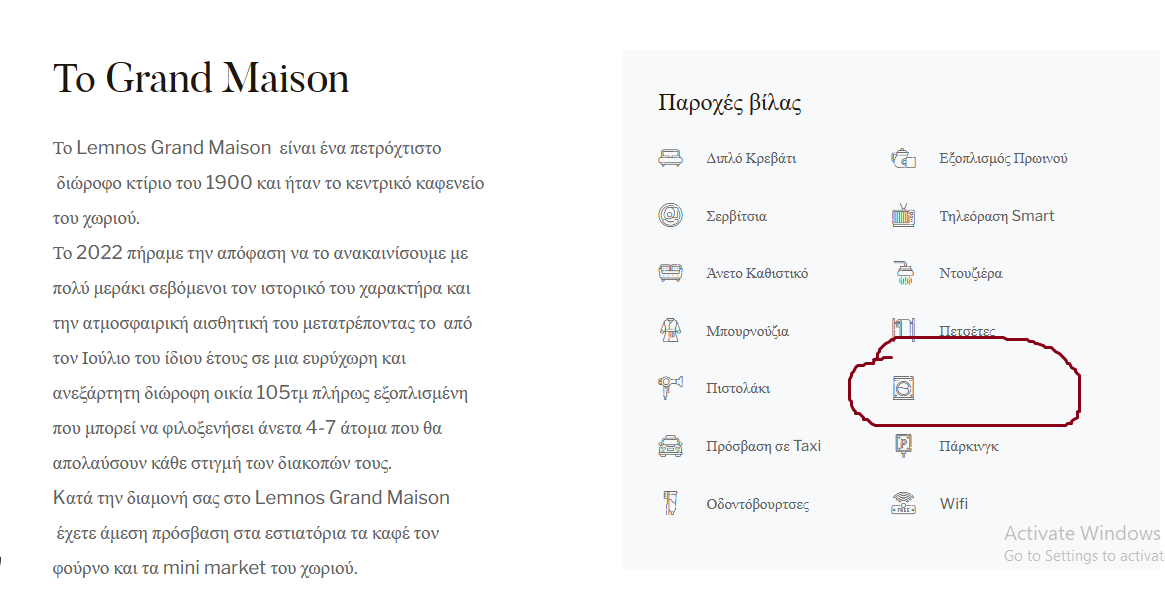

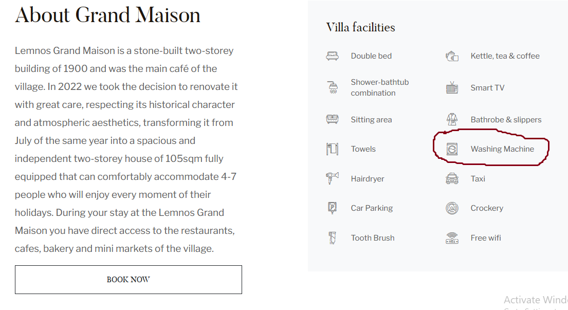

I have hotel template - Ja Ego and in two languages (Greek / English) and i just try to change villa facilities JUST USE ONE WORD > Πλυντήριο (washing machine) and i get that error > Save failed with the following error: Data too long for column 'attribs' at row 1 althought the text is short and everything... in English works... in Greek article page NOT > please urgent help > customer is already late due to small problems (i've sent more issues yesterday)...

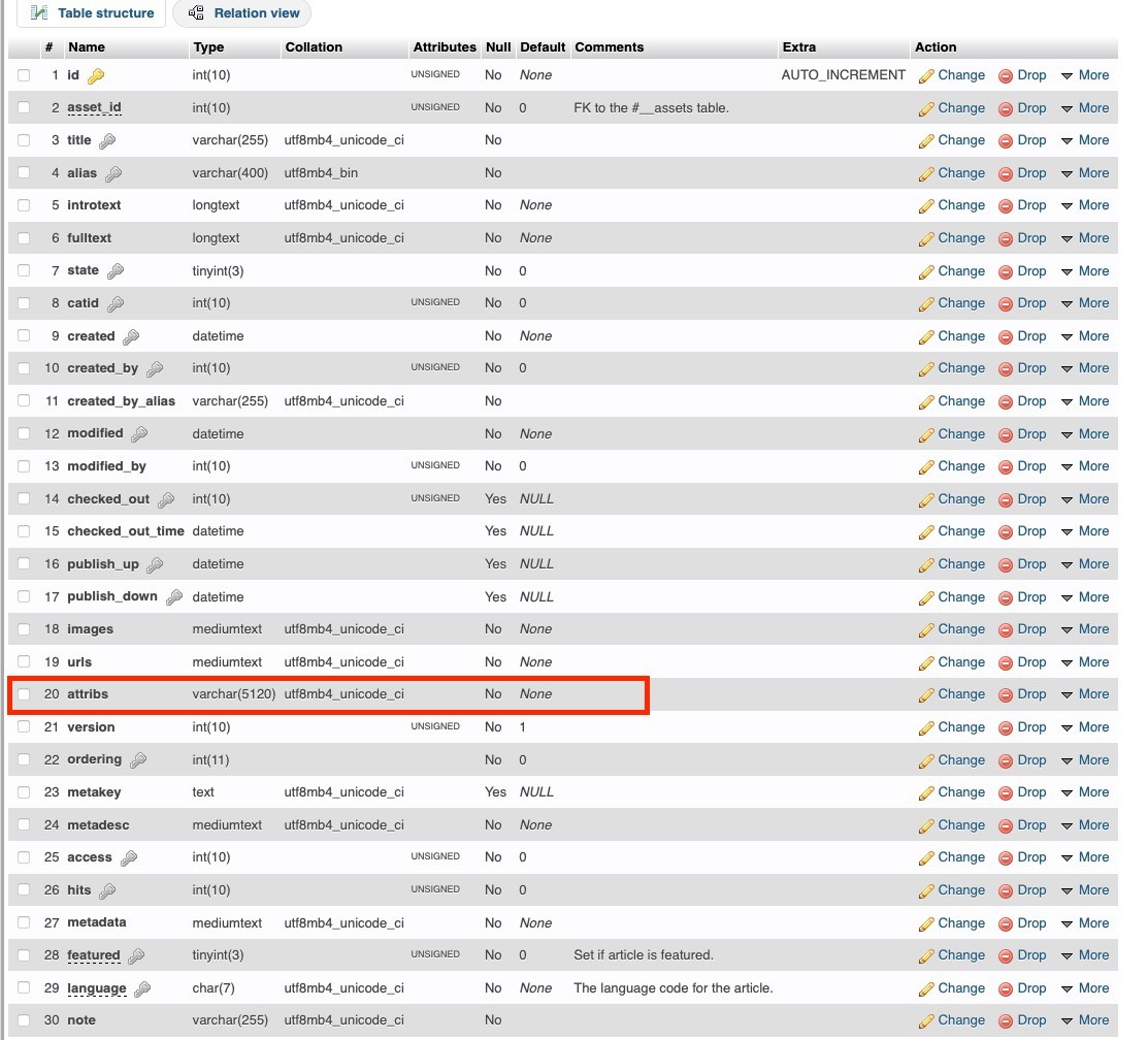

It seems that that the number of contents you have imported exceeds the limit of the type "attribs" of table #__content in SQL. To fix this, you'll need to change the type of attribs from varchar(5120) to longtext. Please consider reaching out to your hosting provider for support or share your hosting login details with us so we will be able to check further for you.

Hi Miltos,
It requires change in database of your site so if you're not familiar with this, I recommend you to contact your hosting for help to update this 'attribs' row for you.
Remember to backup your site first.
